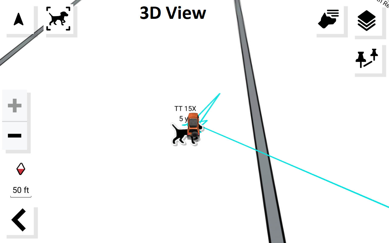

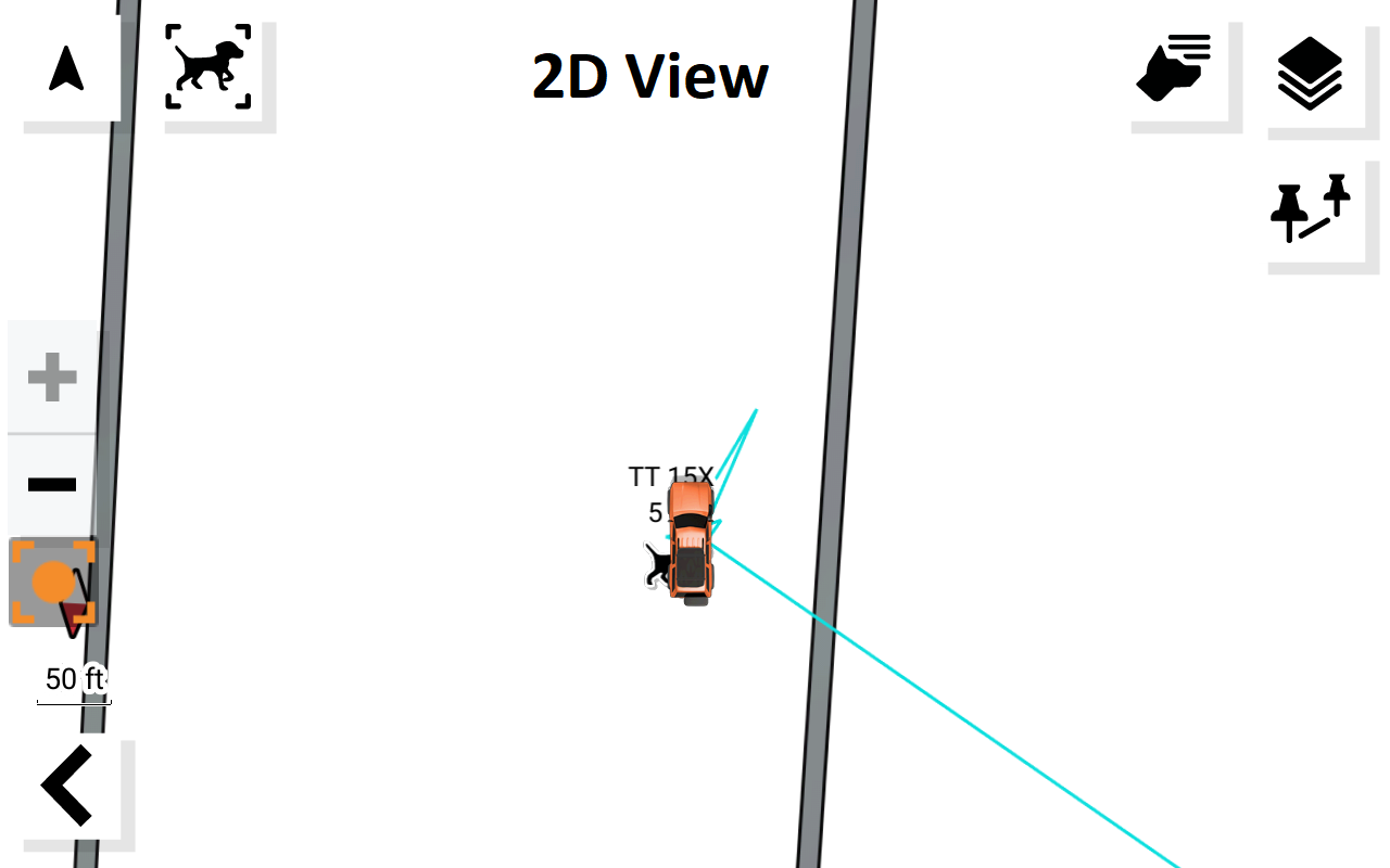

50ft Zoom
The images below are both set to 50ft with the icon and label size set to large. The 2D view is set to 'Track Up' to match how the 3D view functions.
  • 2D View, the dog is hidden behind the car, that the map is much more flat looking.
  • 3D View, the dog is much larger and the car is smaller.

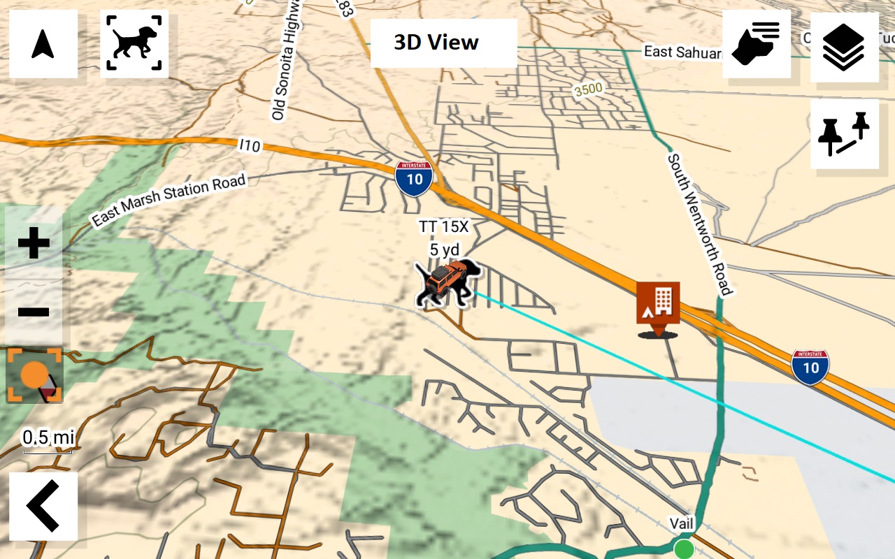

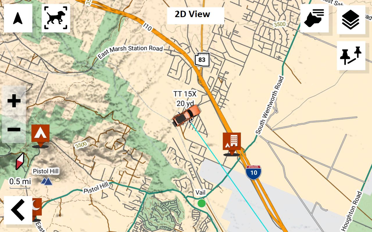

1/2 Mile Zoom Level
The images below are both set to 1/2 mile with the icon and label size set to large. The 2D view is set to 'Track Up' to match how the 3D view functions.
  • 3D View, the dog is much larger and the car is smaller. The map also looks different.

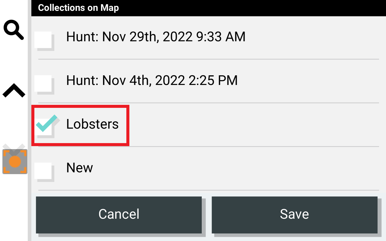

Viewing Your Waypoints
NOTE: Astro® and Alpha® 100 dog tracking handhelds are not compatible with the Garmin Explore™ app, you will not be able to view your waypoints on the Tread® navigator.

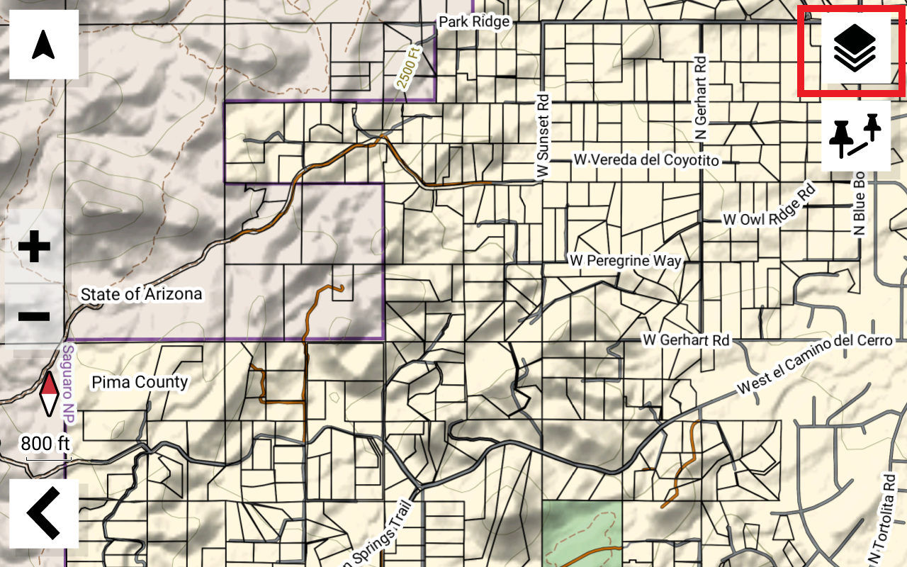

  1. Select Map Layers
    map layers1

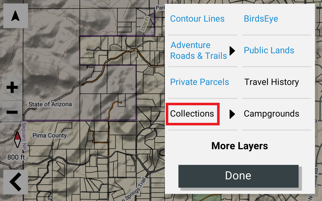

  2. Select Collections
  3. Select the Collection you wish to see on the map
    Select Collections
  4. Select Done
