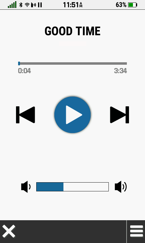

The Montana® 700, Montana® 700i, and Montana® 750i outdoor handhelds feature a data screen that allows you to control the music on a paired smartphone. Available features include play, pause, skip to the next or previous track, and volume. The feature requires the Latest Software On Your Device. This will control the last used media player on your paired smartphone.
Adding the Music Control Feature
  1. Select Home to reach the main menu.
  2. Select Add Page
  3. Select Music Control.

On the Montana, touch Home to reach the main menu, then select Music Control.
