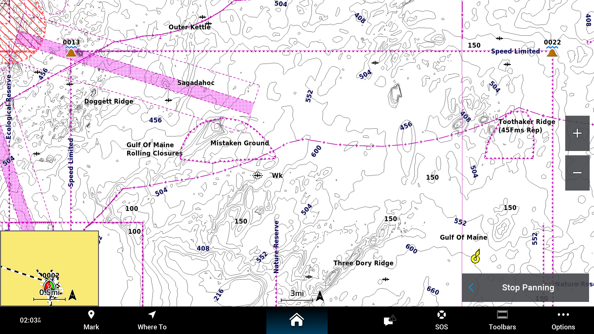

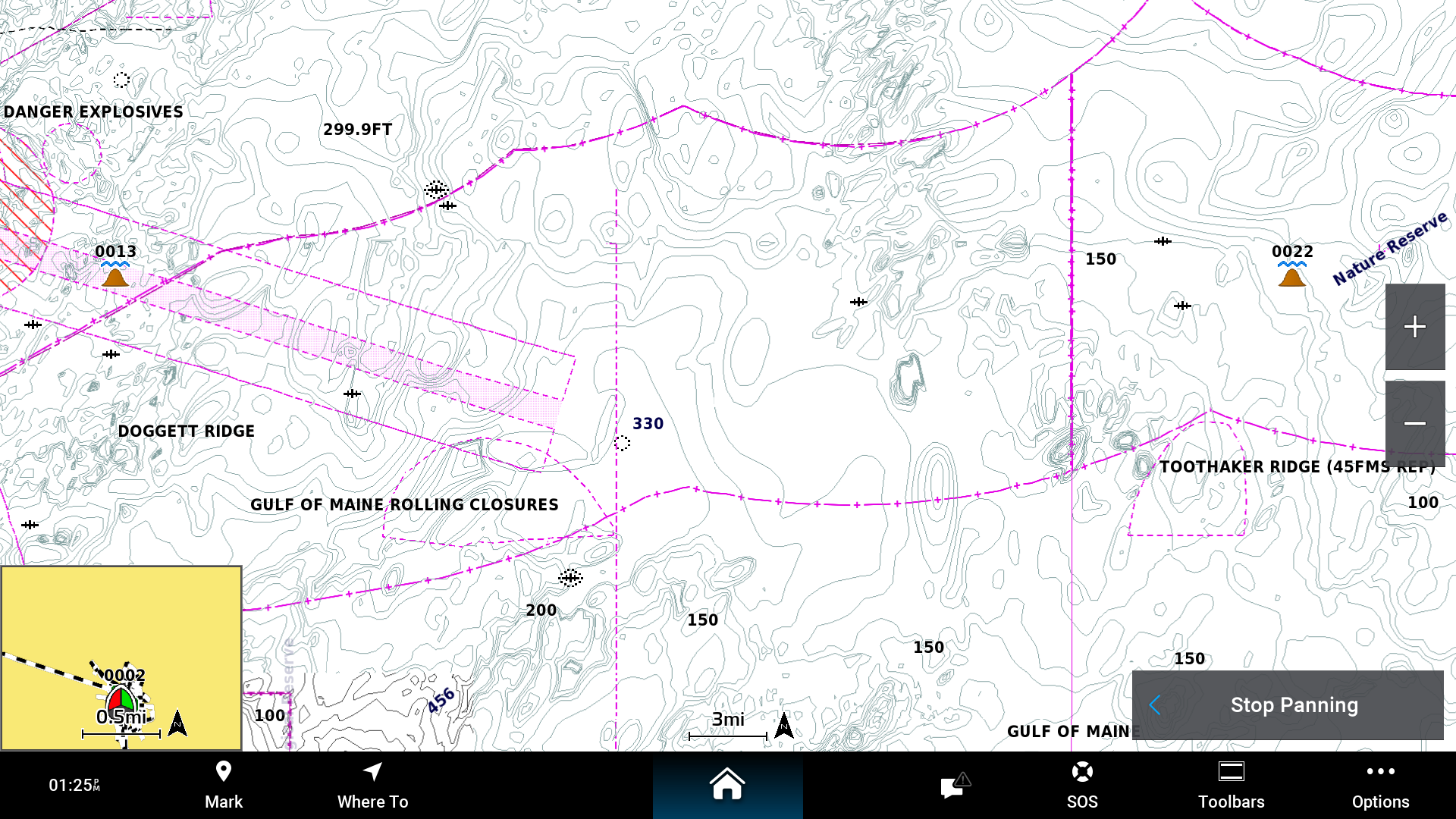

Chart Information Before and After
Chart data before update including new DMA data.Chart data before update including new DMA data.
Chart data after update including new DMA data. Chart data after update including new DMA data.

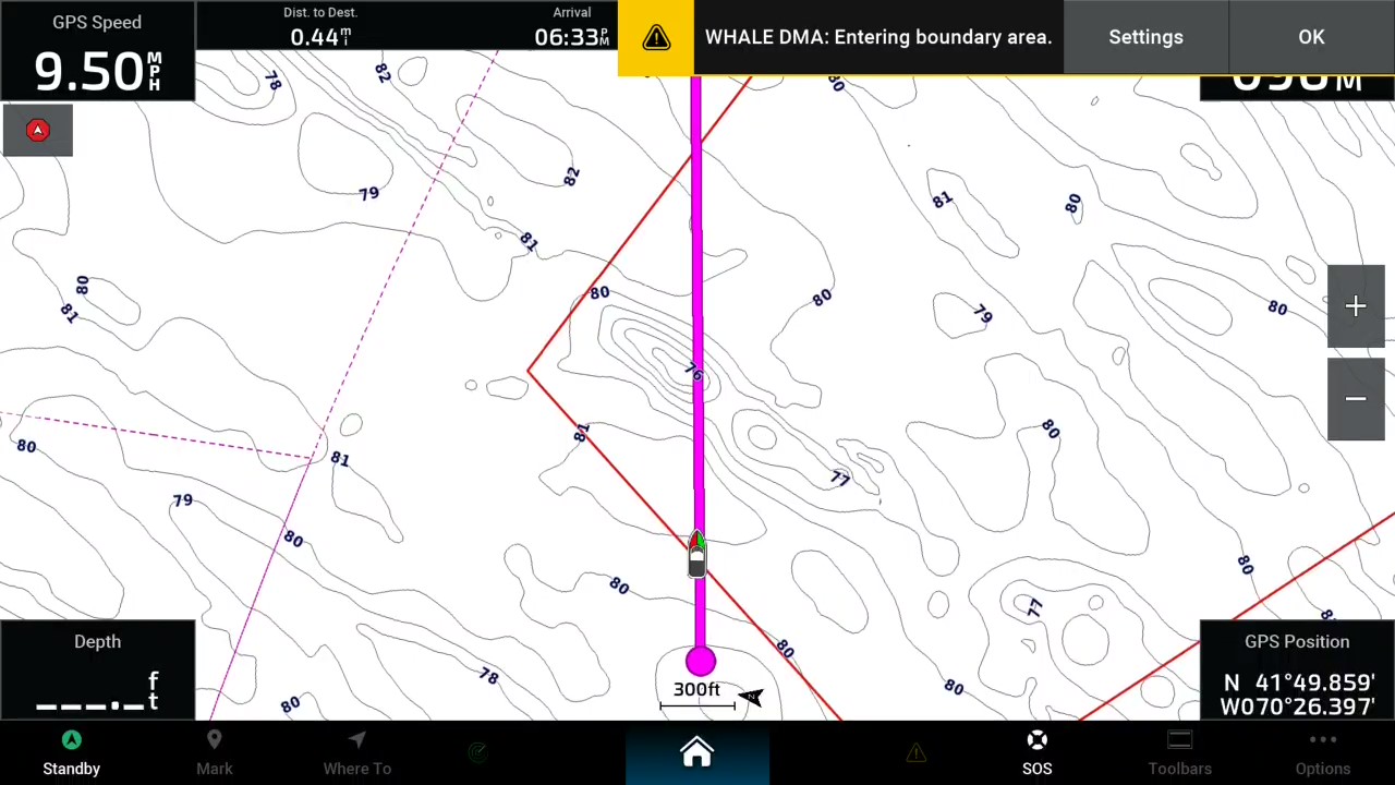

Alarm notification on chartplotter indicating entering boundary area.

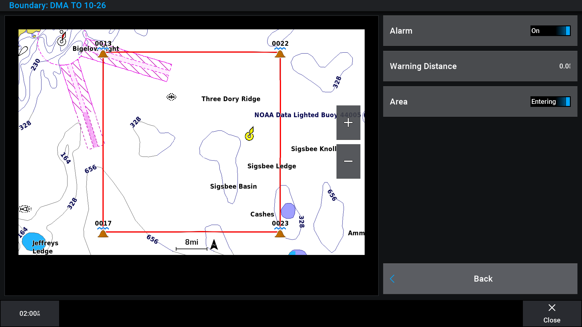

Setting a Boundary Alarm
Boundary alarms alert you when you are within a specified distance of a set boundary. This can be helpful when attempting to avoid certain areas or when you should be very alert in certain areas.
  1. Select Where To > Boundaries.
  2. Select a boundary.
  3. Select Review > Alarm.
  4. Select an option:
    • To set an alarm for when your boat is a specified distance from the boundary, select Warning Dist., enter a distance, and select Done.
    • To set an alarm for when you enter or exit an area boundary or a circle boundary, select Area to show Entering or Exiting.
Boundary alarm menu (step number 2)
