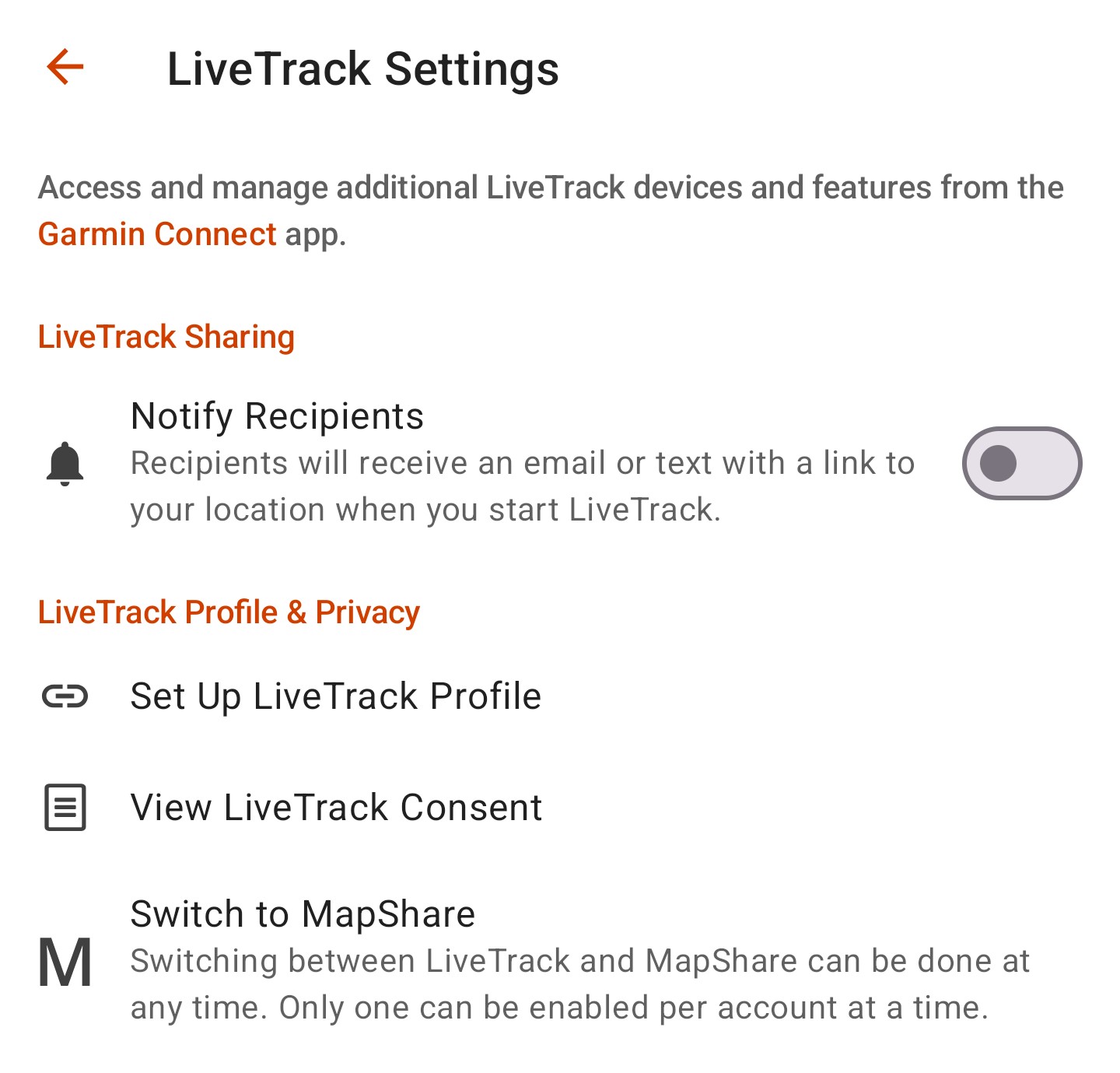

After agreeing to the LiveTrack Location Data Agreement, you will be presented with options to notify recipients, set up a LiveTrack profile, or switch back to MapShare:
LiveTrack inReach Settings
You can get back to these settings at any time by selecting the profile icon or Gear Symbol in the top left of the Garmin Messenger app, then select LiveTrack from the list of settings. Additional LiveTrack settings will be available once you have entered recipients and set up your LiveTrack profile.

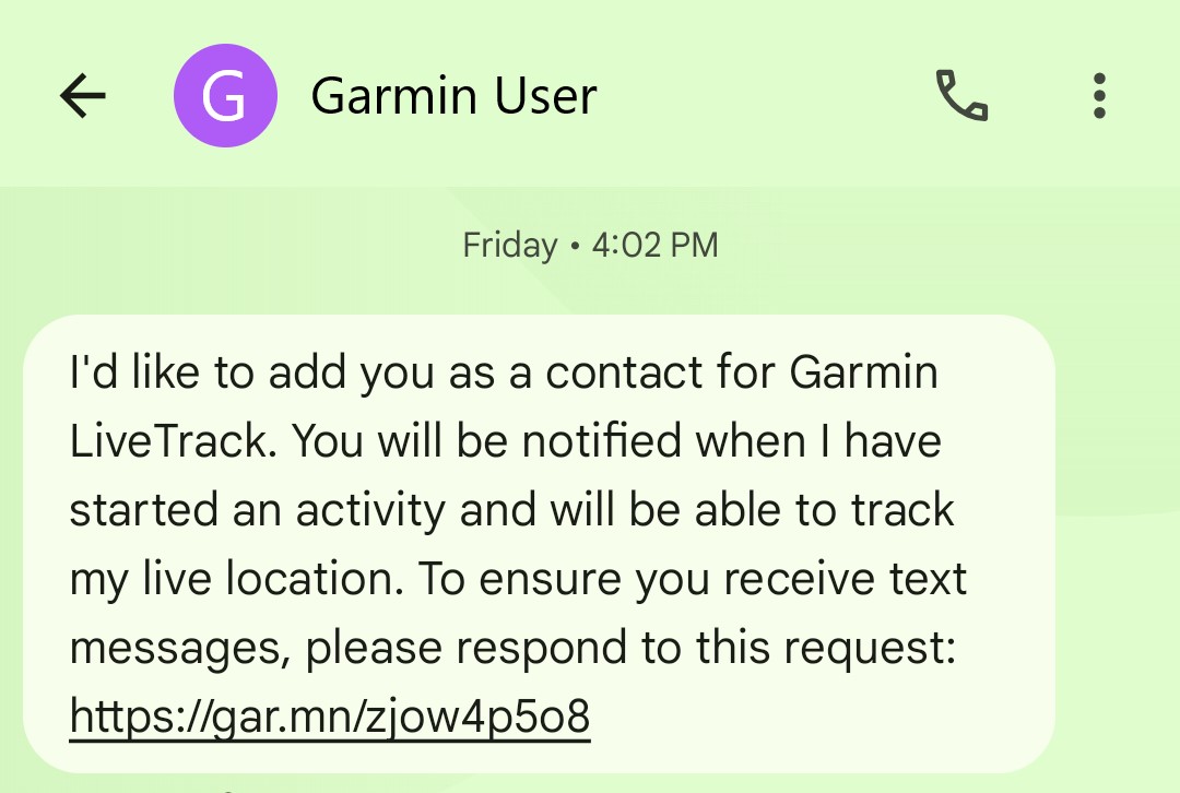

  11. If a mobile phone number was selected, you will then be redirected to your phone's default text messaging app to finishing sending the request as a text message.
After sending a contact request to a mobile phone number, the recipient will need to accept the request in the text message they receive. Once accepted, they will automatically begin receiving text message notifications whenever tracking has been started.

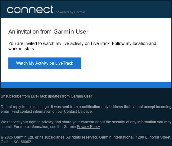

After adding an email contact, there is no need for the recipient to accept the request. They will automatically begin receiving email notifications whenever tracking has been started. If they no longer wish to receive these emails, the recipient can select the Unsubscribe link in the email.
