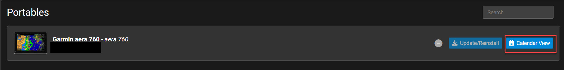

To Purchase an Aviation Database through the Garmin Aviation Database Manager Application:
  1. Open the Garmin Aviation Database Manager application.
  2. Sign in to an existing account.
  3. Select the "Calendar View" button found on the right-hand side of your Aircraft or Portables Dashboard

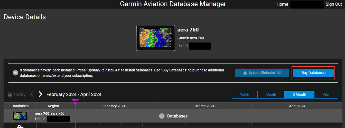

  4. Select the "Buy Databases" button found in the top-right corner of the Aircraft Details or Device Details calendar page.
  5. The flyGarmin.com Buy Databases page will launch in a web-browser window.
  6. Proceed through the same selection and checkout process detailed in the Purchasing an Aviation Database through flyGarmin.com section.
