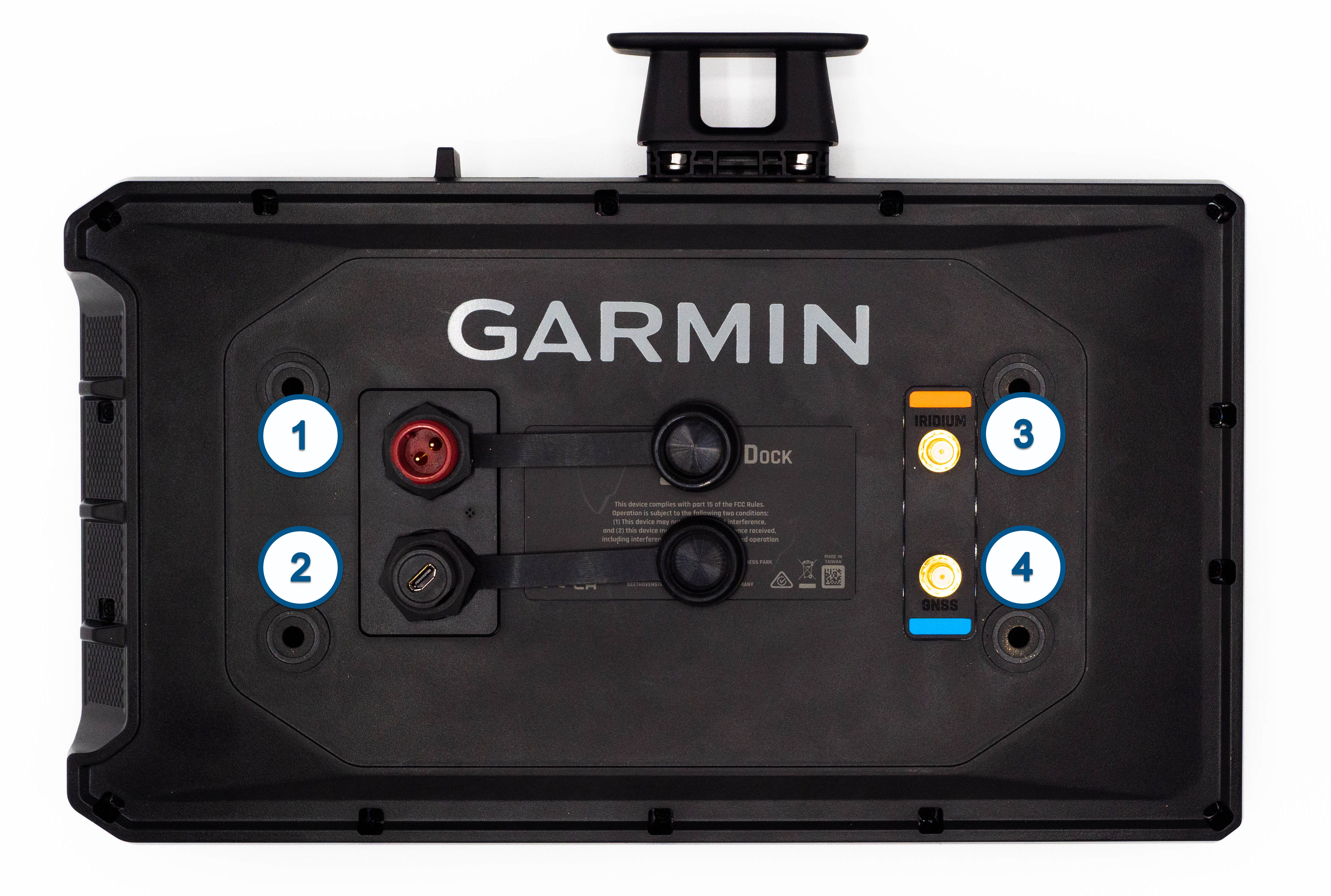

Ports Available on the Tread® XL Dock:
  1. Power Port: Compatible with a 12 Volt Vehicle Power Cable and the High-current Power Cable
  2. Data Port: Connect to an optional Group Ride Accessory
  3. Iridium Antenna Port: Connect External inReach® Antenna
  4. GNSS Antenna Port: Connect External GPS Antenna with Mount
