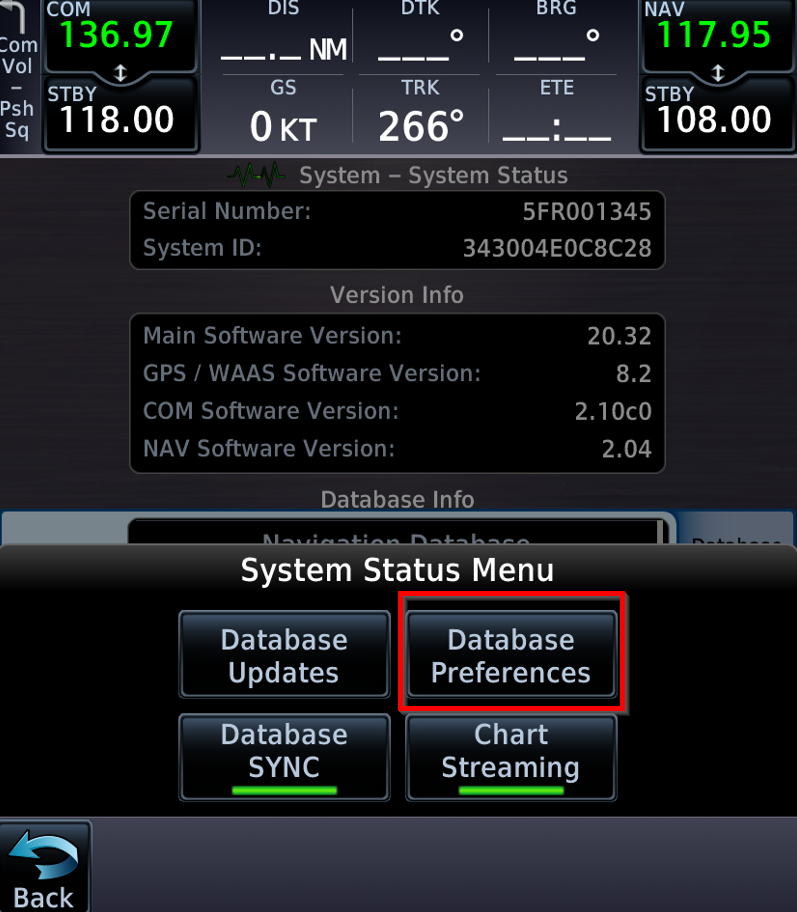

  1. Tap on System.
  2. System Status.
  3. Menu.
  4. Database Preferences.

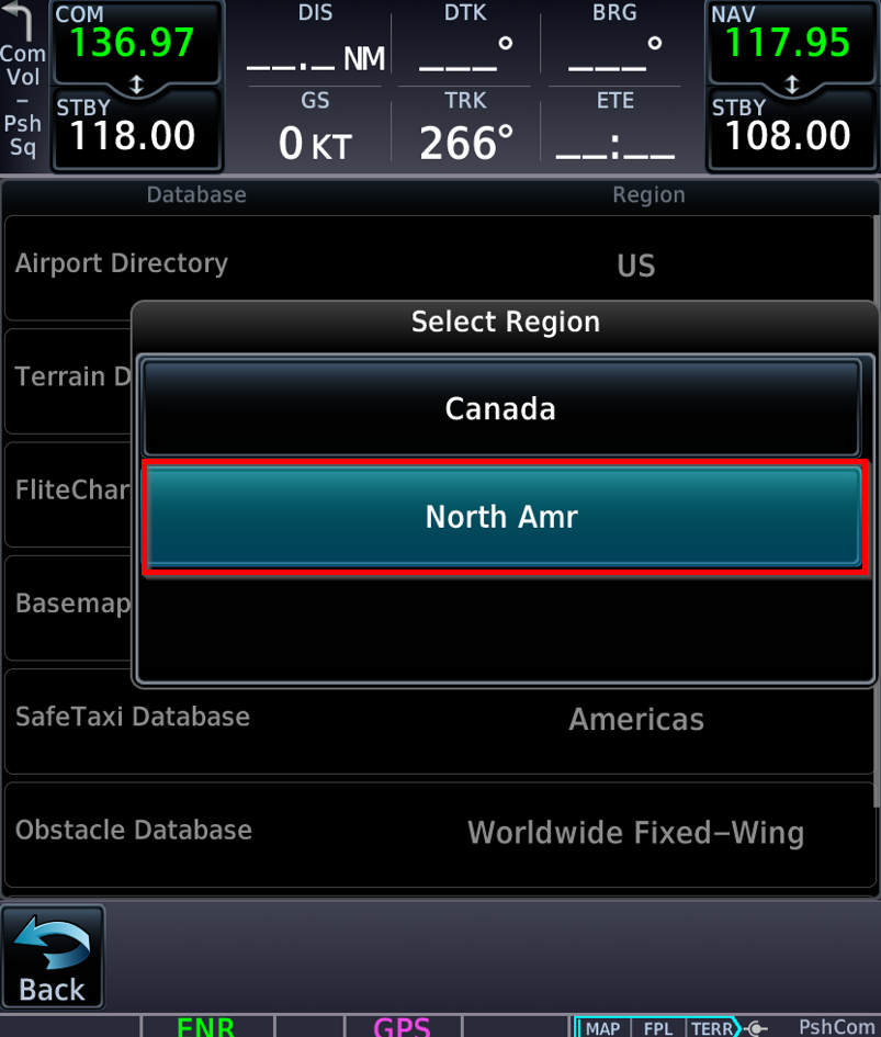

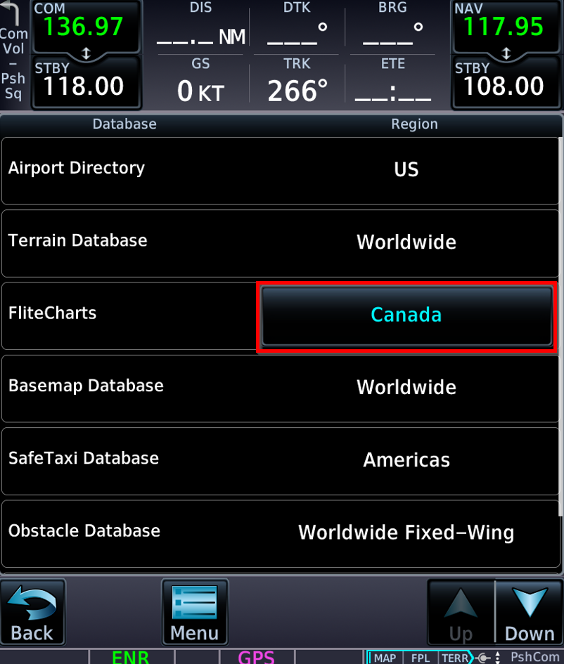

  5. Select the region field on the database you would like to change.

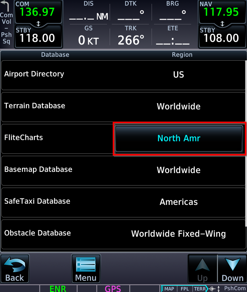

  6. Select the region.
  7. Confirm the new region is selected.

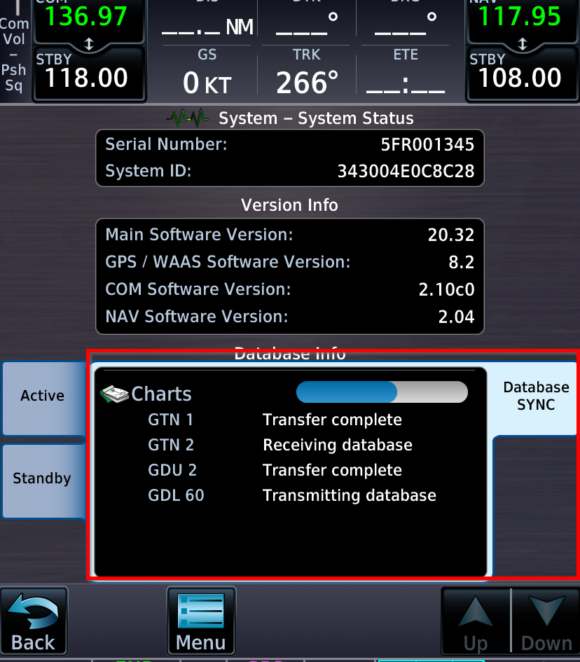

  8. The Database Sync tab can be monitored to see the transfer of the newly selected region across all the compatible avionics.
