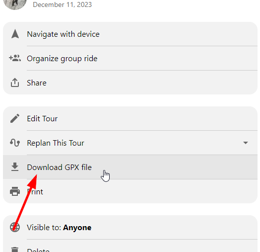

I Do Not See My komoot Tours in Garmin Connect
Komoot tours will only sync with Garmin Connect after they have been downloaded as GPX files. It is not necessary to upload or perform any other actions with the GPX files. Simply downloading the GPX files for the tours will cause them to sync with Connect.
Download GPX Files
