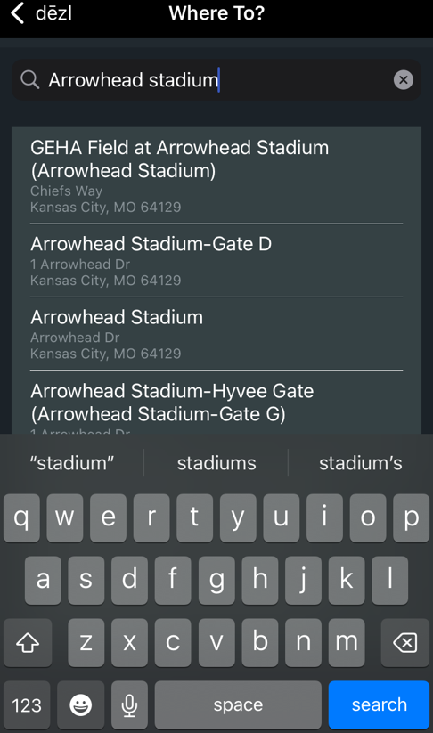

Tips on Searching for Locations in the dēzl™ App:
  • To search for an address near you, enter the house number and street name.
  • To search for an address in another city, enter the house number, street name, city, and state.
  • To search for a business name, enter all or part of the name.
  • To search for a city, enter the city and state.
  • Coordinates are not searchable.
  • As you type, suggestions appear below the search field.

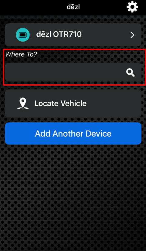

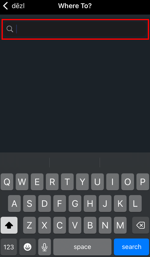

1. From the dēzl™ App, touch the search bar below Where To?
  • You must be signed into the dēzl™ app to see the "Where To?" option. When signed out , only the "Locate Vehicle" button is visible.
2. Search for an address or location
3. Select a suggested search result.

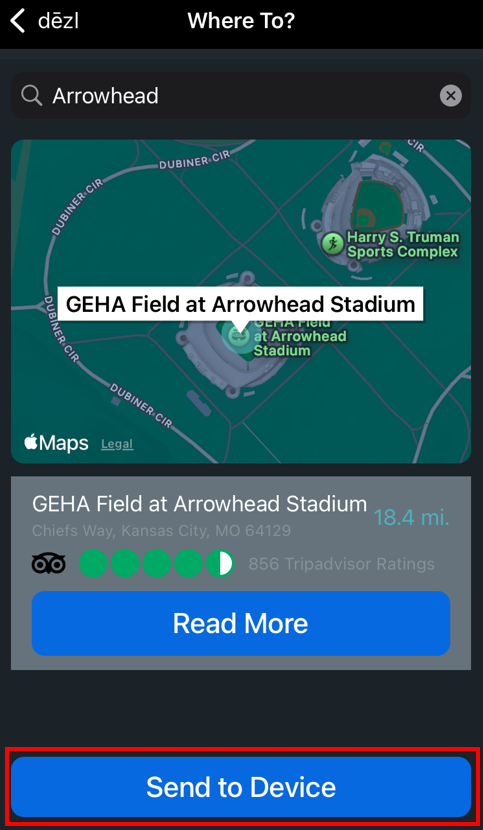

  • The app will display the location on a map.
4. Touch Send to Device to start a route
The Garmin device will start navigating to the selected location. The location will be added to your recent searches in the app as well as the recent locations on the device.

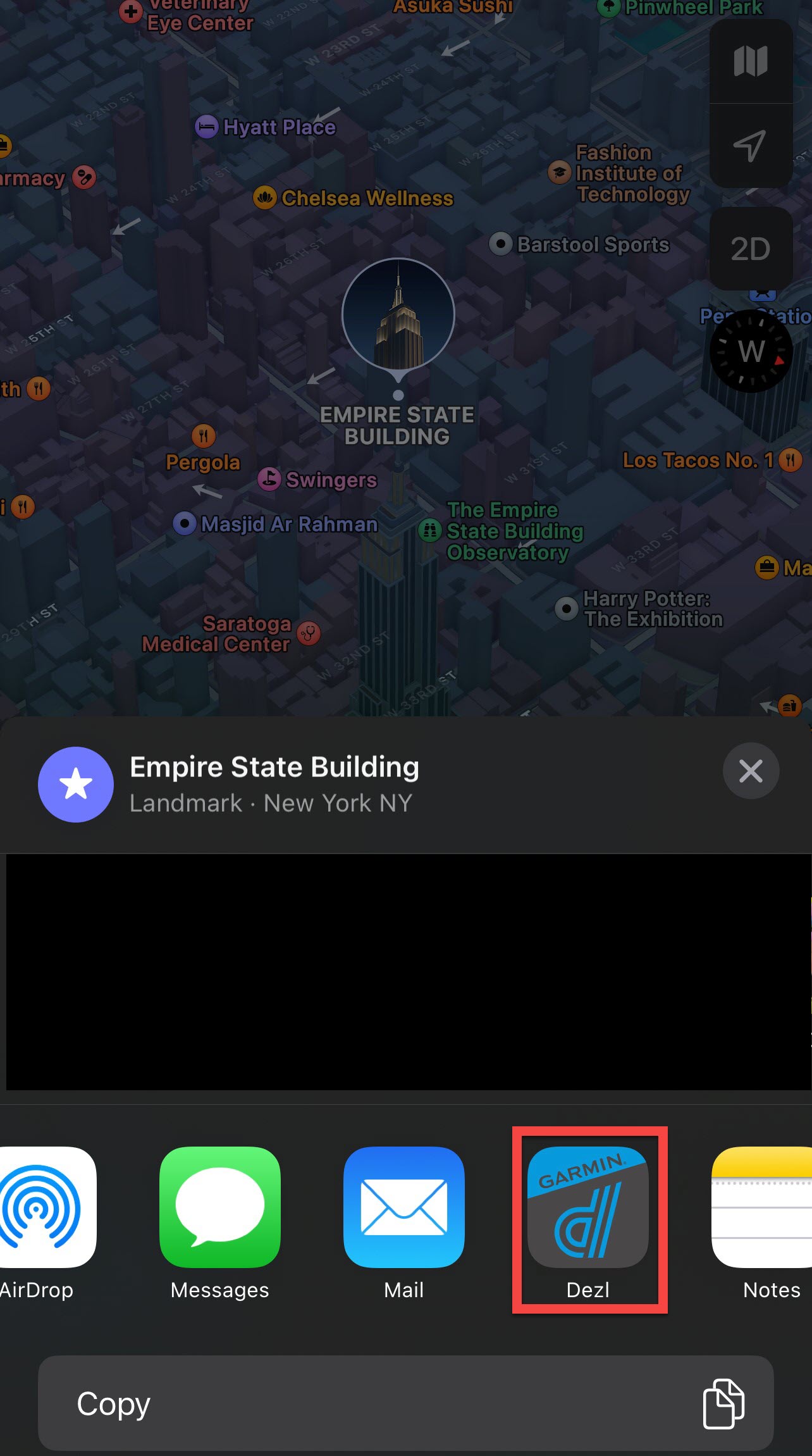

iPhone and Apple Maps
Getting Started:  The Garmin device is powered on and connected to the dēzl™ App on your iPhone
NOTE: Only one location can be sent at a time.

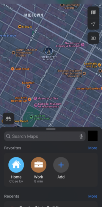

1. Open Apple Maps on your iPhone
2. Input the location or coordinates, then tap search
    • Inputting a Location:
    • Inputting Coordinates:
      • Separate with a comma and do not add a space between the comma and the next set of numbers, (for example 40.748817,-73.985428), then tap the search icon

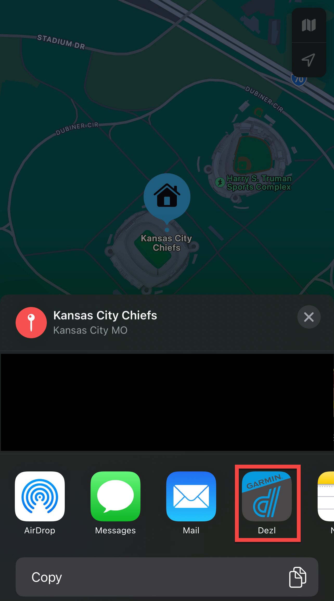

3. Confirm the location on the resulting page. Touch the Share icon
Empire State Share
4. Tap the dēzl™ app Icon
Empire State Dezl
5. Ensure your Garmin device is turned on and has acquired satellites
6. Tap Send on the iPhone once the Garmin Dezl App pop-up confirms the destination
Touch send Empire
