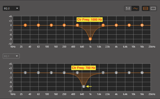

In Figure 1, the effect of adjusting only the "Center Frequency" of a filter can be seen. Both graphs show a single filter with a "Q" of 1.41, and a Gain cut of -9dB. The only difference is the "Center Frequency" value. The top graph indicates a Center Frequency of 1000 Hz for EQ Band #6. The bottom graph shows the effect of changing the Center Frequency downward, to 700 Hz. TuN™ allows the user to select, for each EQ band, any "Center Frequency" value between 20 and 20,000 Hz.
MVi Amp CTR FREW
Figure 1

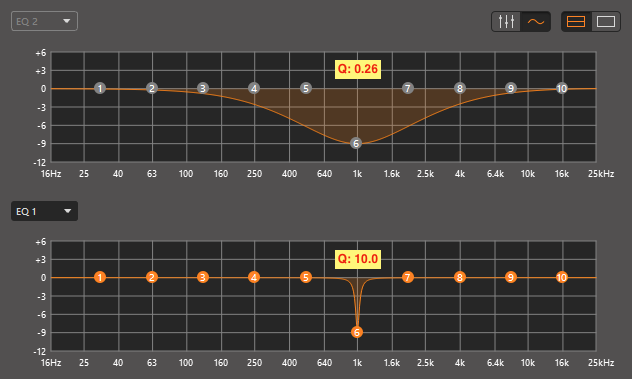

In Figure 2, notice the effect of adjusting only the "Q" of a filter. Both graphs show a single filter with a Center Frequency of 1000 Hz and a Gain cut of -9dB. The only difference is the "Q" value. The top graph shows the widest possible "Q": 0.26. The bottom graph shows the narrowest possible "Q": 10.0. TuN™ allows the user to select any "Q" value between these extremes, giving immense control over EQ correction.
MVi Amp HiLo Q
 Figure 2

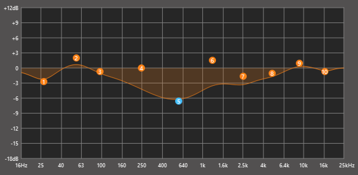

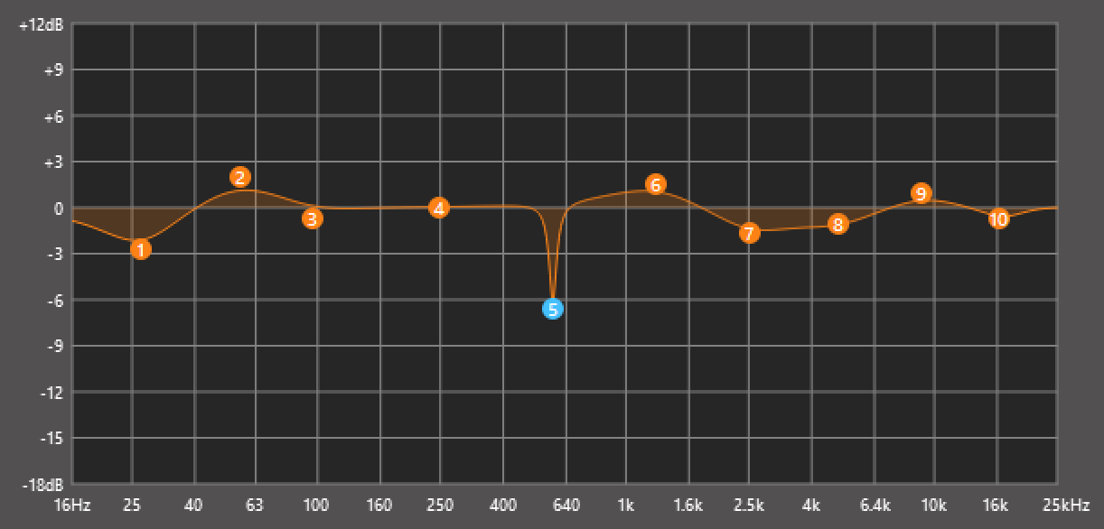

With a parametric EQ, it is possible to achieve highly complex frequency response curves using fewer filters than would be used with a graphic EQ. In practice, 10-bands of parametric equalization are just as powerful, if not more powerful, than 30 bands of graphic equalization. Here are two examples of complex curves, using multiple bands of parametric EQ.

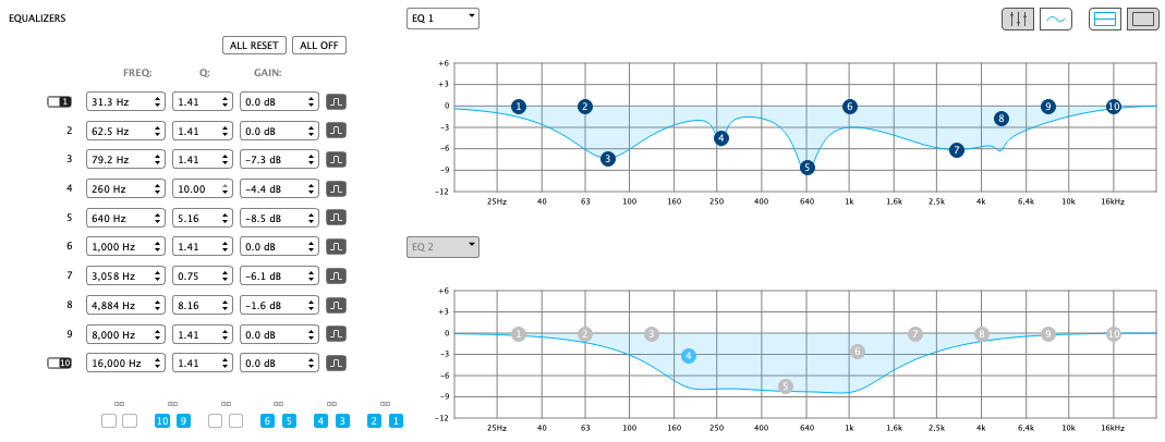

Manual EQ adjustment on the display graph: In Parametric EQ mode, the numbered, round EQ Band labels on the display graph can be directly selected and moved using the mouse/touchpad. The graph will display the resulting effect on frequency response in real time. The resulting value changes will also be reflected in the EQ numerical entry fields.
Manual commands:
  • Left Click and Hold, then Drag Up/Down for Boost/Cut
  • Left Click and Hold, then Drag Left/Right to change Center Frequency (Parametric EQ only)
  • Right Click and Hold, then Drag Up/Down or Left/Right to change “Q” (Parametric EQ only)
  • Control+Left Click to select multiple EQ bands. These can then be adjusted together.
EQ adjustment with Arrow Keys: The user can also select EQ Band Label(s) with a mouse/trackpad, and then make adjustments using the arrow keys on the keyboard. Finer adjustments steps can be achieved by using the SHIFT key, in conjunction with the arrow keys.
Keyboard commands:
  • Up/Down Arrows: Boost/Cut
  • Left/Right Arrows: Center Frequency down/up (Parametric EQ only)
  • CONTROL + Up/Down Arrows: “Q” Up/Down (Parametric EQ only)
  • Control+Left Click to select and adjust multiple EQ bands.
 Individual Band Defect Individual Band Defeat: Individual EQ bands can be defeated (turned off), by clicking the icon located to the right of the numerical entry fields. To re-engage them, click the icon again.
Dual or Single EQ Views Dual or Single EQ Views: These icons allows the user to choose whether to display one or two EQ display graphs on the screen. This way the user can work on two EQ banks at once, or just focus on one with better resolution. Linked EQs are always displayed together, on one display graph.
Graphical or Parametric EQ Mode Graphic or Parametric EQ Modes: These icons allow the switch between Graphic and Parametric EQ modes.
IMPORTANT: Switching from Parametric to Graphic mode RESETS the preset’s EQ banks to default (flat) settings.
All Reset: Resets all EQ bands to their default values
All Off/On: Temporarily defeats/turns on all EQ bands
EQ Select: Select an EQ to adjust from the pull-down menu (Linked EQ’s are shown as pairs).
EQ Link EQ Link: Allows Left and Right EQ Banks to be linked and adjusted together, with identical settings.
