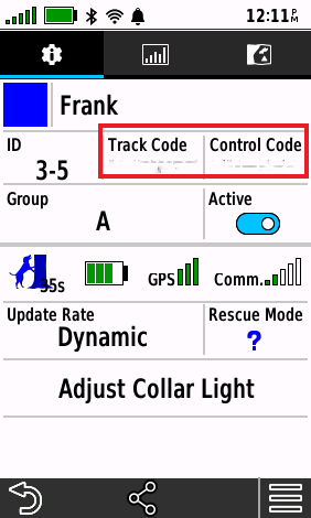

Find your track and control code
  1. Select Dog List
  2. Select the dog you want to share
    track control code
