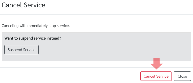

  4. Select Cancel Service.
    Red Arrow Pointing to Cancel Service Confirmation
