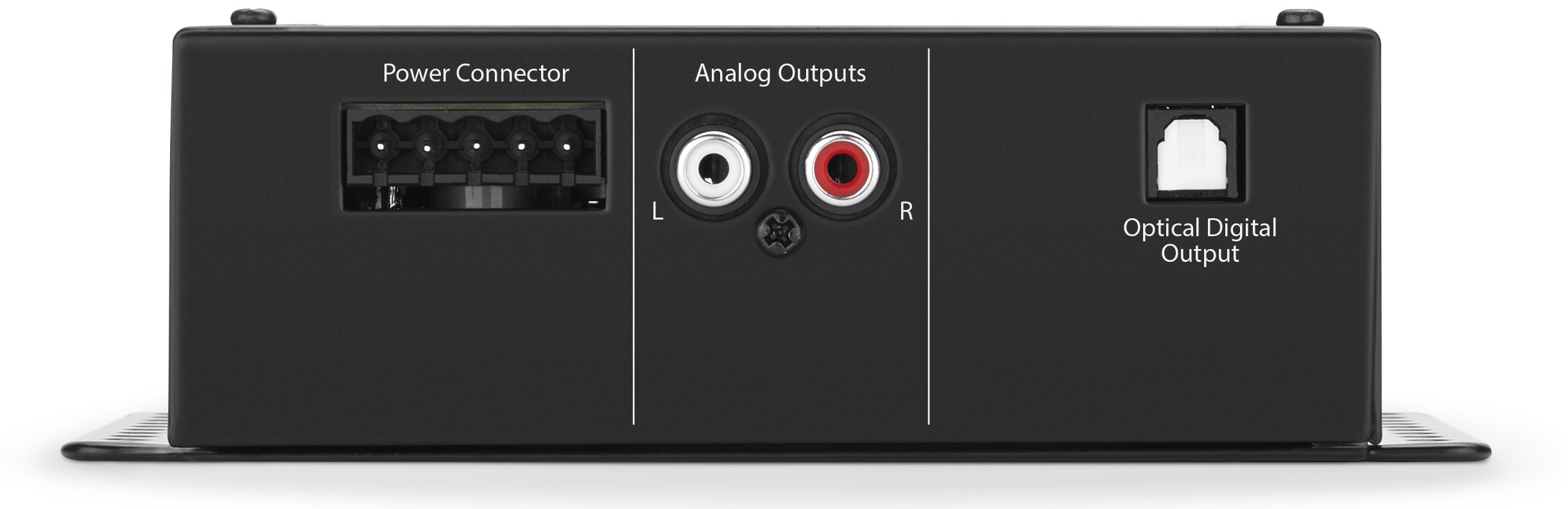

The FiX® 82 offers two output types to feed audio signals to your aftermarket system. Choose the output type that is appropriate for the specific equipment of your audio system.
Analog Outputs: Two RCA-type, 4-volt (RMS) line-level output jacks are located next to the “Power Connector” and are labeled for each channel (Left and Right). Analog outputs are compatible with most types of aftermarket signal processors or amplifiers. The level of this output is proportionate to the FiX® 82’s input signal and may also be controlled by the optional DRC-100 Digital Remote Controller (sold separately).
Optical Digital Output: This jack is located next to the “Analog Outputs” and provides a digital audio output that is not susceptible to RF interference or noise-generating electrical conditions. This digital output is intended for use with a TwK® System Tuning DSP (sold separately) or other signal processors or amplifiers that have an optical (Toslink) digital audio input (S/PDIF) jack. The level of this output is proportionate to the FiX® 82’s input signal and is not affected when used with the optional DRC-100 Digital Remote Controller (sold separately). For remote level control, you may use the DRC-200 Digital Remote Controller that is included with the TwK® System Tuning DSP (sold separately).
