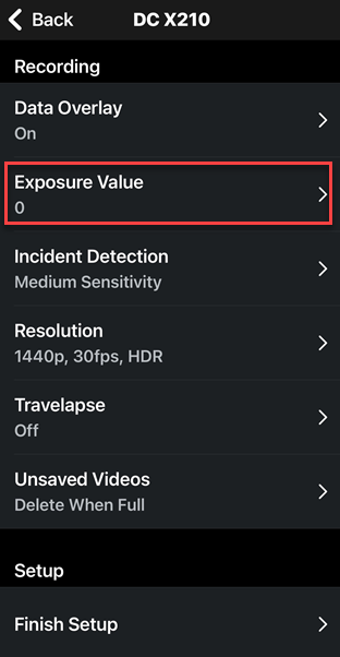

3. Select the dash cam within the Vehicle
  Drive App Settings Select Dash Cam

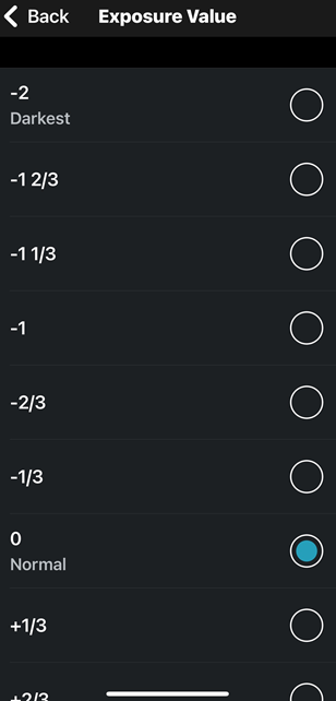

4. Touch Exposure Value
Drive App Exposure Value Setting
5. Touch an exposure setting to select it (slide the page up to view more options)
Drive App Exposure Value 1
