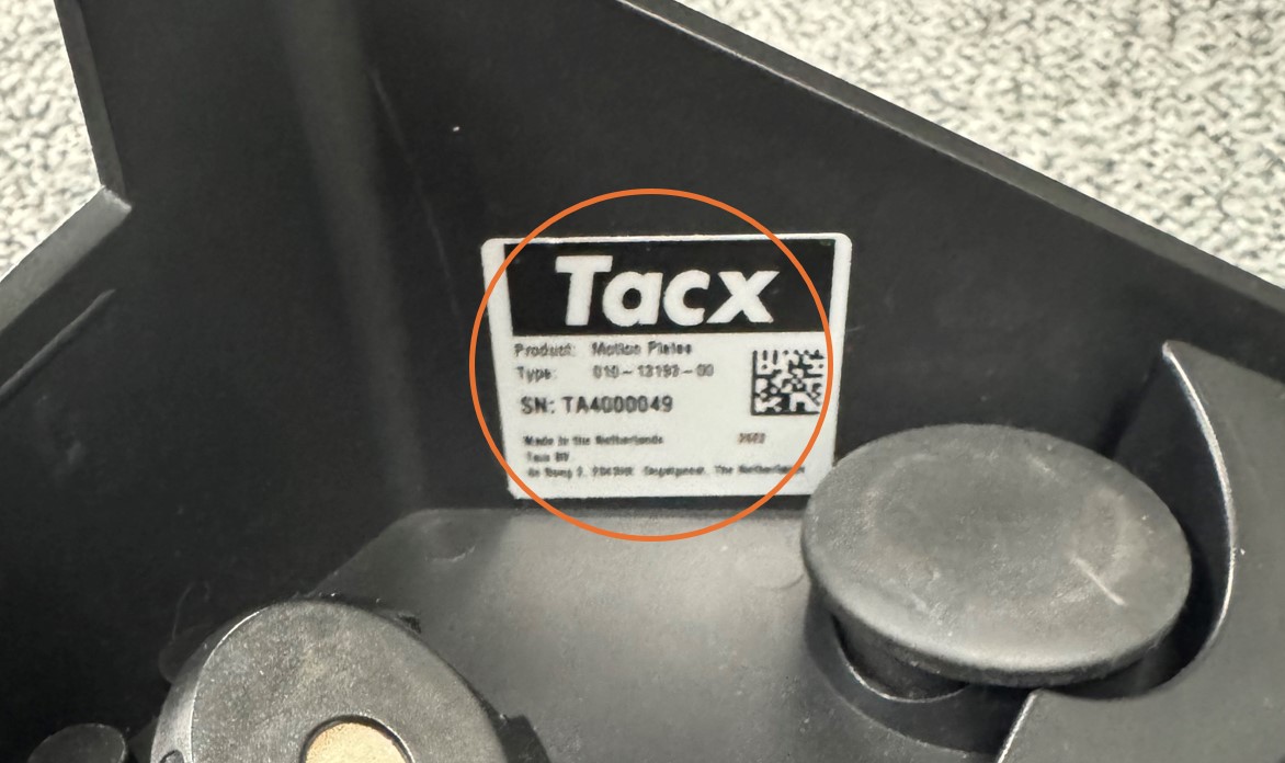

Tacx NEO Motion Plates
The serial number for Tacx® NEO Motion Plates is on the inside of the non-drive side plate.
motion plate serial number on inside of plate
