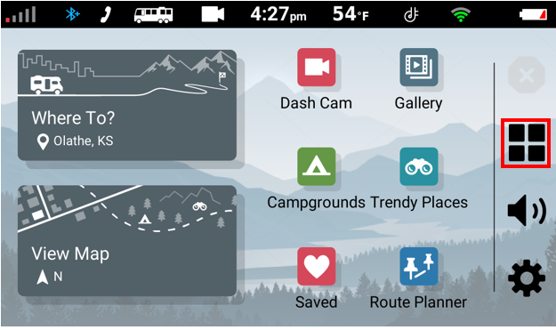

1. Touch Apps

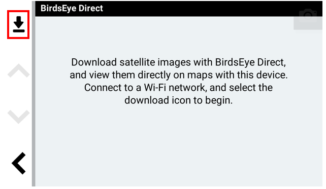

2. Touch BirdsEye Direct
3. Touch the Download icon

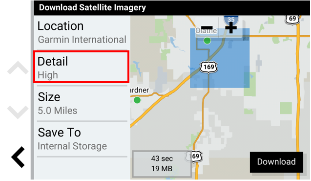

5. Touch Detail to select an image quality option. Select an option and touch Save.

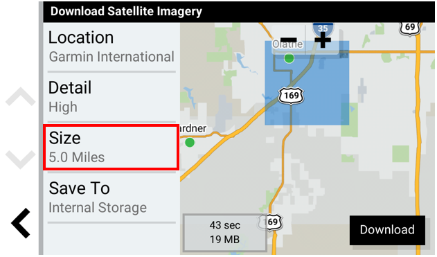

6. Touch Size to enter the size of the area to be shown in the downloaded imagery files. Enter a distance from the selected location and touch Done.
    • The maximum size of BirdsEye area depends on the location and detail level set.

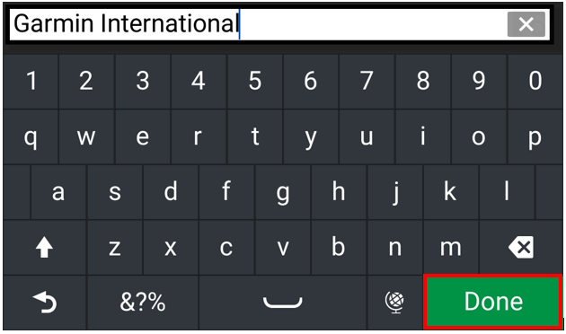

9. Enter a name and touch Done
