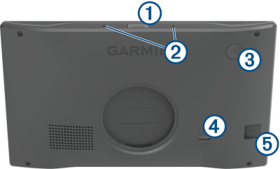

AMAZON ALEXA
- Voice Button. Press if you want to manually activate the Amazon Alexa voice feature.
- You can also say 'Alexa' to activate the Amazon Alexa voice feature.
- Hold for two seconds to mute the microphone for voice features.
- This feature requires Amazon Alexa setup. See - ''Connected Features - Garmin Drive App' below for steps.
MICROPHONES
- For voice command features and hands-free calling.
- See 'OK Garmin - Voice Command' below for activating and tips.
POWER BUTTON
- Hold the power button down to manually turn on, or turn off the device.
- Tap the power button to go into standby mode.
See - Difference Between Turning Off an Automotive Device and Activating Standby/Sleep/Suspend Mode
USB POWER AND DATA TRANSFER PORT
- To power the device, charge the device internal battery, or to connect to a computer for data transfer.
- See - 'Power and Battery Charging' below for requirements and tips.
- See - 'Transfer Favorites' below for steps to send saved places from one device to another.
MAP and DATA MEMORY CARD SLOT
- A microSD card with at least 16 GB and no larger than 256G of space must be used when the map updates no longer fit in the internal storage of the device.
- The update program will alert you when an SD card is needed.
