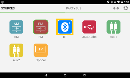

  2. From the Home screen of the stereo display, select the Source icon
    vieo sources button
  3. Select BT
    vieo select BT

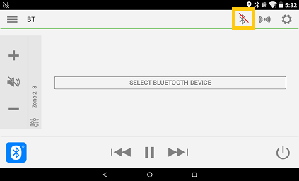

  4. Select the Bluetooth icon
    vieo turn on bluetooth

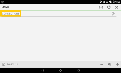

  5. Select Connections
    select connections

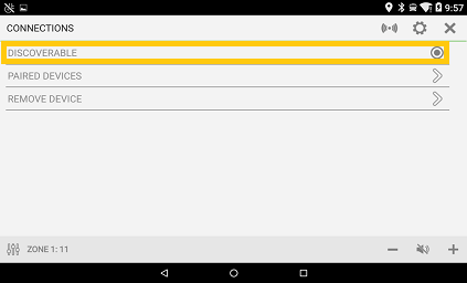

  6. Select Discoverable to turn it on
    select discoverable
