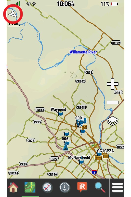

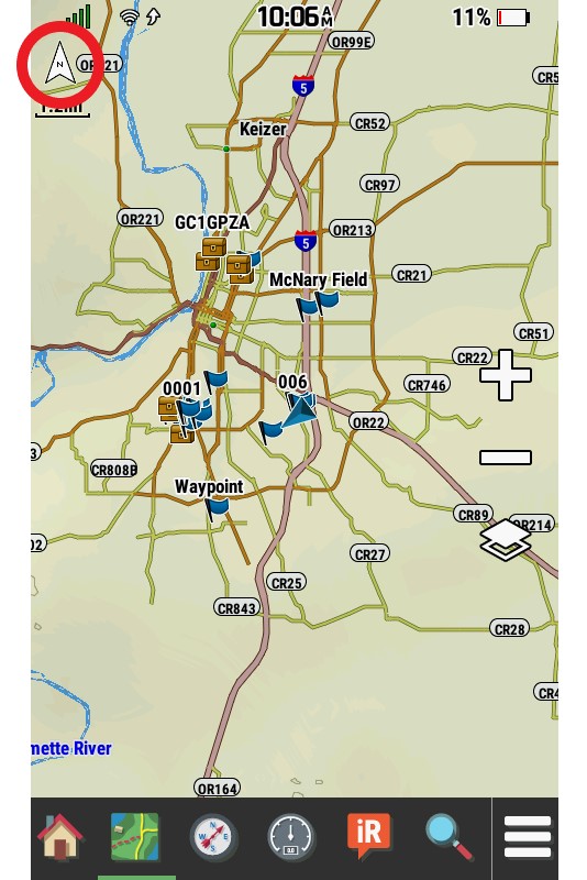

Tapping the North Arrow
If Track Up has been selected in the settings, as described above, a North arrow will appear in the top left corner of the map. Tapping on the North arrow allows you to toggle back and forth between Track Up and North Up orientations.
Examples of North Arrow
Track UpNorth Up
Montana Track Up MapMontana North Up Map
