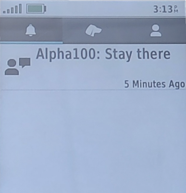

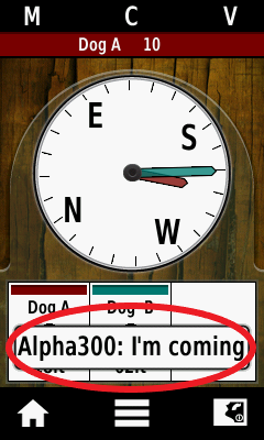

Viewing Messages
Messages will appear on the handheld screen for approximately 10 seconds before disappearing.
Alpha 200/300 Series
You are able to view previous messages on the Alpha 200 or Alpha 300 series handheld by pressing the power button and selecting the Alerts button indicated by a bell on the handheld.
Alpha300 Compass Message
Alpha 300 Previous Messages

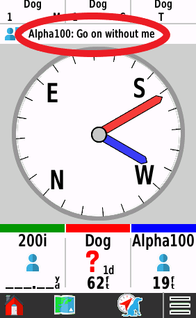

Alpha 100
NOTE: You are not able to view previous messages on the Alpha 100 handhelds.
Alpha 100 Message
