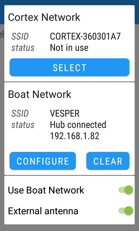

From the Boat Network block, choose Configure. Input the credentials for the Boat Network.
Network Config Cortex
Turn Boat Network On/Off
Once the Cortex Hub is configured to connect to the Boat Network, it can be toggled On or Off. Green indicates Boat Network is On. Grey indicates Boat Network is Off.
When Boat Network is On, Cortex Handsets and devices using the Cortex Onboard App will be able to access the Cortex Hub fully.
Important: Have at least one Cortex Handset on the Cortex Network. The Cortex Network will not have other device traffic on it and will therefore offer a more stable connection without the risk of poor performance caused by other systems.
