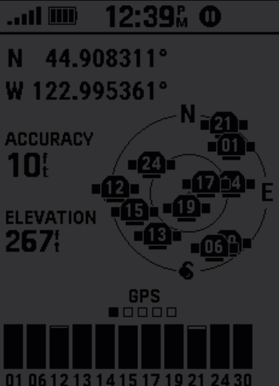

The satellite page on the eTrex® SE and eTrex Solar outdoor handhelds shows coordinates for your current location, GPS accuracy, satellite locations, and signal strength. You have the ability to quickly view the different satellite systems directly from the satellite page.

    Satellite Page
