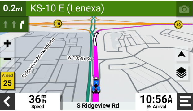

When set to 3D view, the map will take on a 3-dimensional appearance; the direction you're traveling will remain at the top of the screen.
  • The compass will not appear in 3D view.

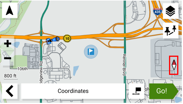

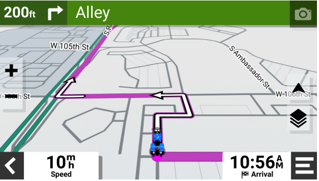

North Up Mode

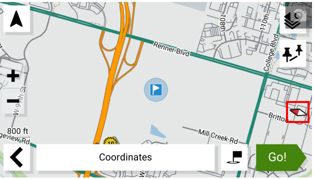

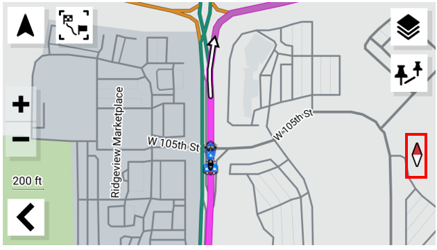

Touch the map screen to see the compass.
Touching the map screen will show the compass in the lower right.
  • Map example when not in a route.
  • Map example when in a route.

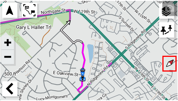

Track Up Mode

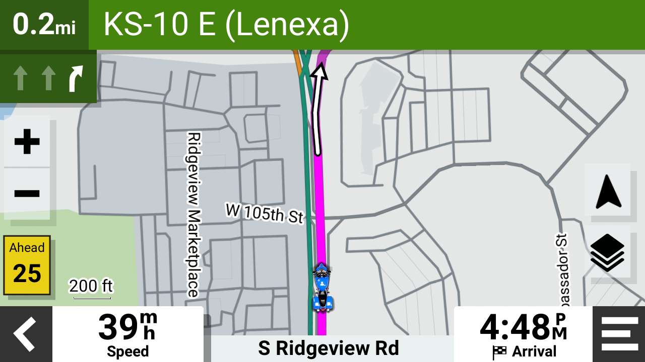

To Use the Map Orientation Map Button:
The Map Orientation map button can be used as a compass in Track Up and North Up view.
  • The button does not allow for panning around the map.
  • Can be used during navigation without having to touch the map screen first.
  • Allows for quickly switching between Track Up, North Up, and 3D views.

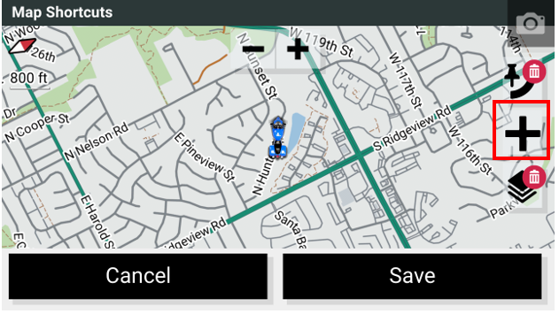

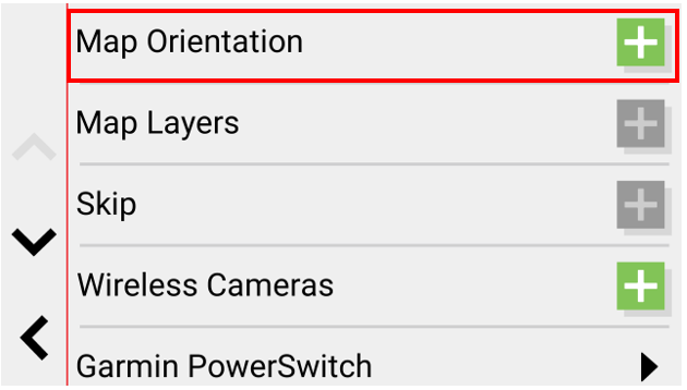

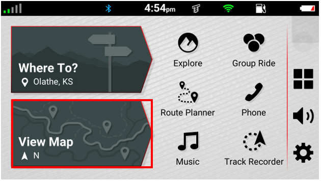

1. Touch View Map
2. Touch Map Tools
3. Touch the wrench icon
4. Touch the plus icon
5.  Touch Map Orientation

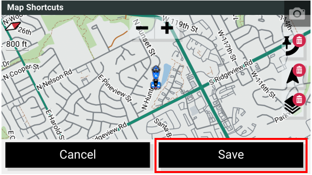

6. Touch Save
7. The Map Orientation button will now appear on the map screen
