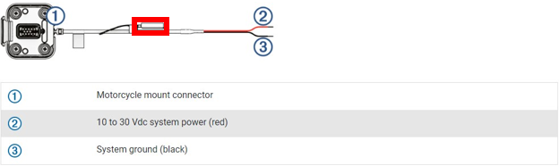

  • Keep pins dry and covered with the included weather cap
    • The included rubber weather cap is attached to the power cable as seen below
  • Apply dielectric grease to the pins to create a thin protective coating on the surface of the pins
