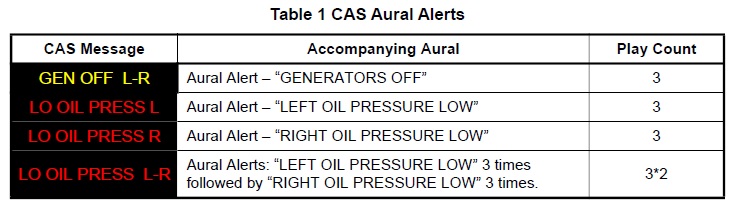

STC ST01918WI, Master Drawing List 005-01202-00 Rev 26 approves G5000 System Software Version 3343.05. This software inhibits engine-related crew alerting system (CAS) aural alerts listed in Table 1 when the aircraft is on the ground and the engine(s) is intentionally shut off by the crew.
NOTE
The CAS messages will appear on the display as previously certified.
