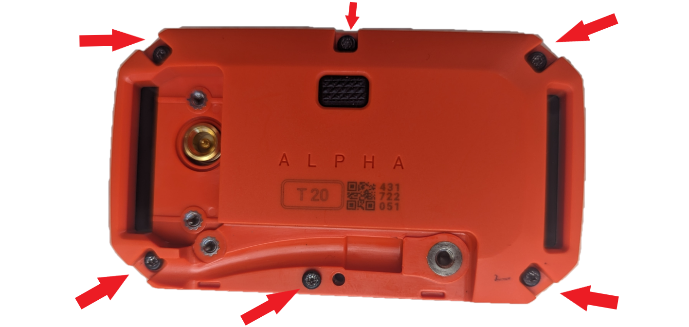

    1.  Remove the six (6) T5 hex screws.
      T20 Battery Change 1

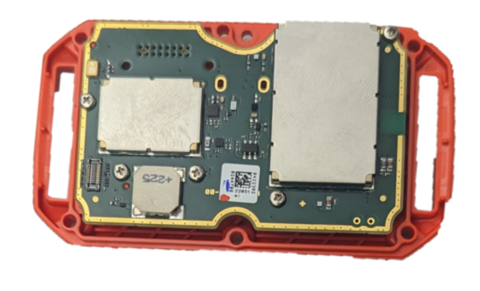

    2. Carefully remove the top plate and set it to the side.
      top plate t20

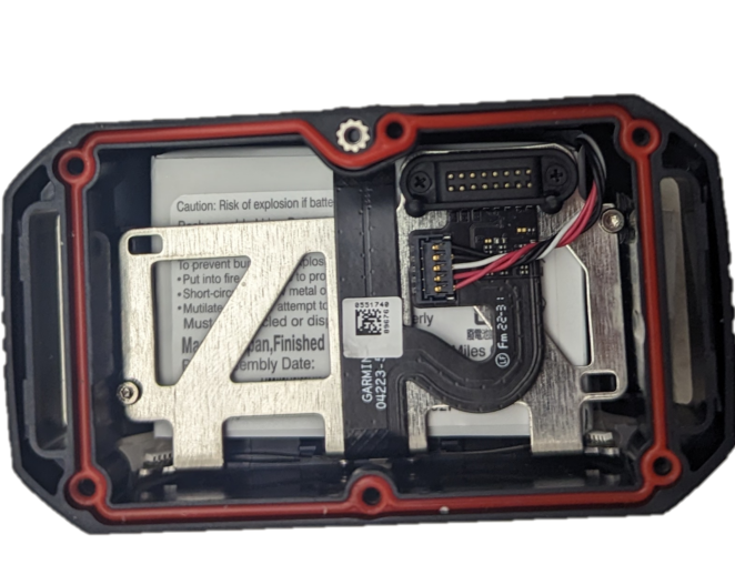

    3. This entire unit left over is the battery. As pictured below.
      battery change t20t20 battery pack
    4. Discard the old gasket as the new battery should already have one installed.
    5. Take the top plate and put on the new battery pack. Ensure the top plate is fit snug.
