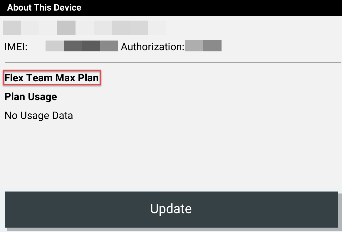

Ensure the Device has a Flex Team Plan:
The Team Tracking feature will not function without the proper plan being active on the device. To ensure your device is on the correct usage plan:
  1. Select Team Tracking
  2. Select the Wrench icon in the top left
  3. Select About This Device
  4. Verify a Flex Team Plan is listed above Plan Usage
Check Plan usage
NOTE: All compatible plans will start with 'Flex Team.' All devices being used with Team Tracking are required to be under the same inReach Professional Account for the devices to communicate and track one another.
