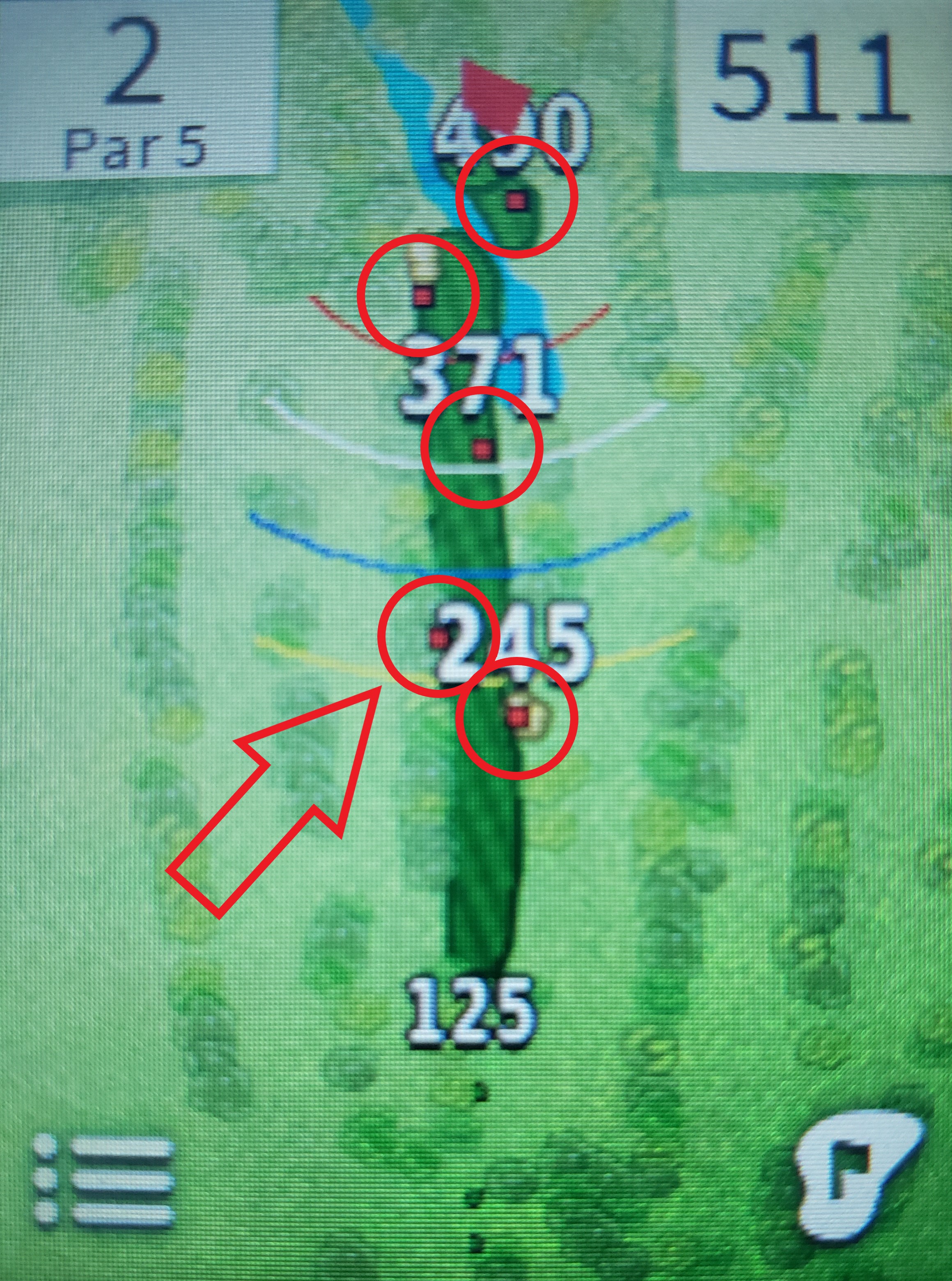

  • Saved locations will show as a red dot on the map of that hole (see the image below for an example - the red arrow points to one such red dot and we have placed red circles around the locations for easier viewing.)
    Example
    Saved Locations G30
