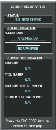

5.)  Press the ENT Key. The system displays the CONNEXT REGISTRATION Window as shown below:
register connext 2
6.) Enter the access code provided by Garmin Flight Data Services in the ACCESS CODE field.
7.) Press the ENT Key. ‘REGISTER’ will now be highlighted as in the image above.
8.) Press the ENT Key. The system contact Garmin Flight Data Services. System registration is complete when ‘REGISTERED’ is displayed in the STATUS field.

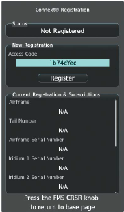

5.) Press the ENT Key. The ‘Connext Registration’ Window appears.
6.) Enter the access code provided by Garmin in the ‘Access Code’ Field.
7.) Press the ENT Key. ‘Register’ is highlighted.
8.) Press the ENT Key. The system contacts Garmin through the Iridium network. System registration is complete when the Current Registration window displays the correct information for the Airframe, Tail Number, Airframe Serial Number, and Iridium Serial Number.
9.) When finished, push the FMS Knob to remove the ‘Connext Registration’ Window.
