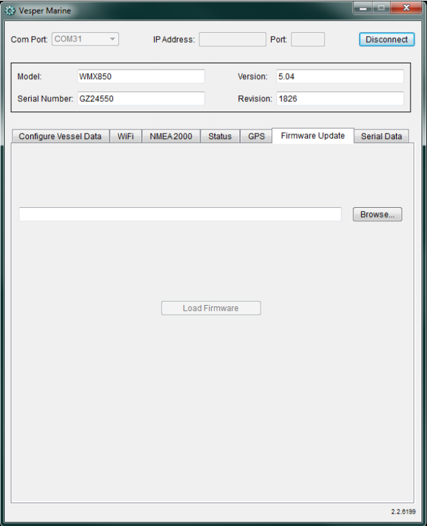

  8. Run the vmAIS Configuration and Status program that was installed in step three. It can be found in the Windows Start menu in the Vesper Marine folder
  9. Select the appropriate COM port which was displayed when the WMX850 was connected to the computer’s USB port and press the “Connect” button. Ignore the IP-Address and Port fields since these are not used with the WMX850. Note: If there is an error or it fails to connect and it is certain that the correct COM port was selected, unplug the WMX850 from the USB port and try again. For some reason, certain Windows versions seem to need this
  10. Select the “Firmware Update” tab and click on the “Browse” button
  11. Select the firmware file that was extracted in step two (firmware files have a .VEB4 extension) and click the “Load Firmware” button
  12. The update will take several minutes. Do not disconnect the WMX850 from the computer or switch off the power during the update
  13. When the update is complete, the WMX850 will restart itself
VESPER Marine Software Screen
