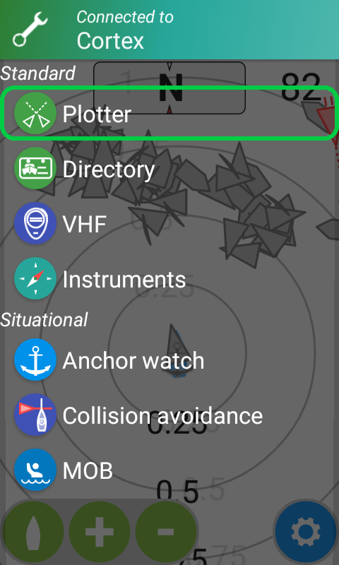

The Cortex® handset and Cortex Onboard™ app can change the view orientation on the Plotter and Situational views.
From the main menu, go to the plotter view.

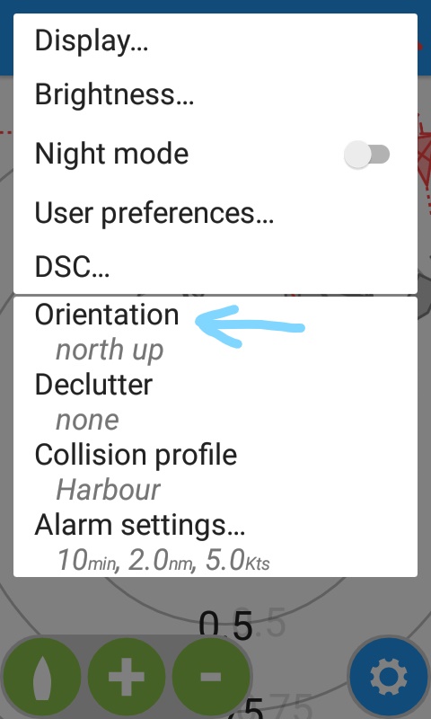

 1 Orientation
Tap on the gear wheel

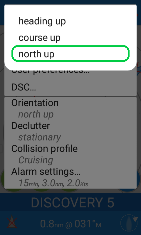

2 Orientation
Choose the Orientation, either north up, course up, or heading up.

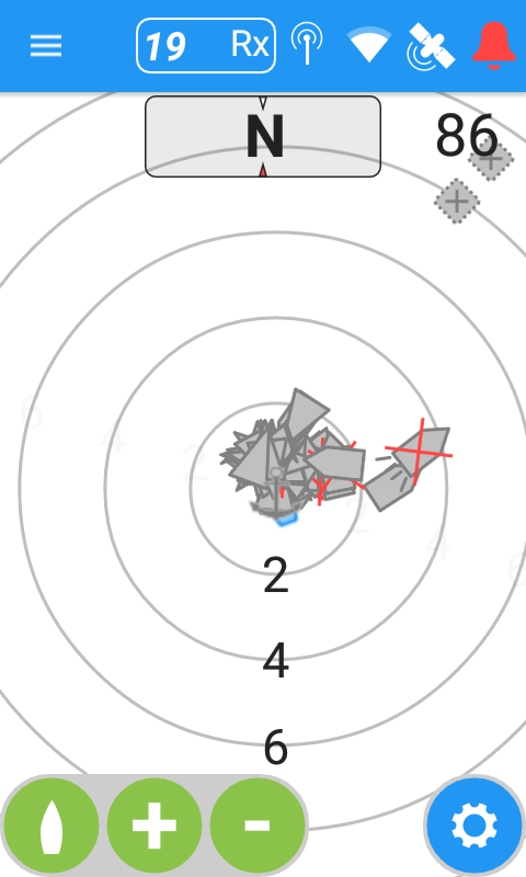

 3 Orientation

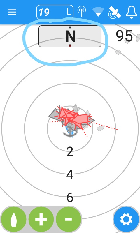

4 Orientation
After the selection is made, press the back key (on the smartphone) twice to go back to the plotter view.

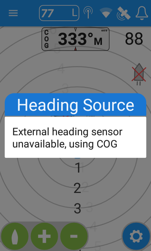

5 Orientation
The heading indicator on the plotter view will indicate which orientation is currently in use. When heading up is in use, tapping the indicator will explain the current choice of heading source.
