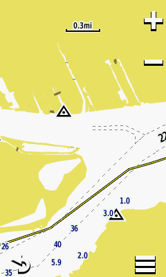

  • Off: The default setting and should be used if you are using other mapping outside of marine mapping
    Off Example
    Image of Marine Chart mode off

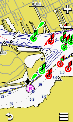

  • Nautical: Displays various map features in different colors so the marine POIs are more readable
    Nautical Example
    Image of Nautical Marine Chart Mode

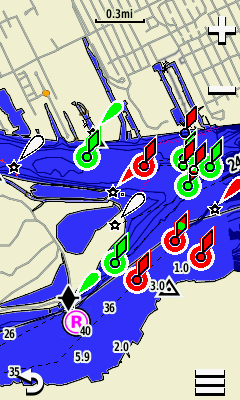

  • Fishing: Displays a detailed view of bottom contours and depth soundings and simplifies map for presentation
    Fishing Example
    Image of Fishing Chart Mode
