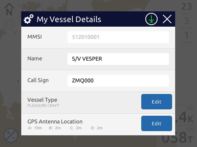

Configuring vessel details
The WatchMate Vision will not transmit the vessel details until configured. The dealer may have already configured this information, and this procedure can be used to verify that the data is correct.
Configuring requires an MMSI number for the vessel. Contact the relevant authority to obtain an MMSI number.
The MMSI number cannot be changed by the end-user. To change the MMSI, contact an authorized Garmin dealer.
The vessel details may be configured or viewed directly on the WatchMate Vision or using the Vesper Marine WatchMate App for iPhone and iPad or Android phones and tablets. The vmAIS Configuration and Status Utility (see downloads section) can also be used for this purpose. Download and install it on the PC, Mac, or Ubuntu computer to use the utility. Connect to the WatchMate Vision via USB or WiFi.
Choose AIS Settings and edit My Vessel Details from the Vision Settings Menu. Enter the MMSI and other details carefully; this information transmits to all vessels within range. Select the most appropriate vessel type and enter the location of the GPS antenna. Enter the location of the GPS antenna in meters or feet. Measurements in feet are converted to full meters for transmission. As a result, not all measurements in feet can be represented.

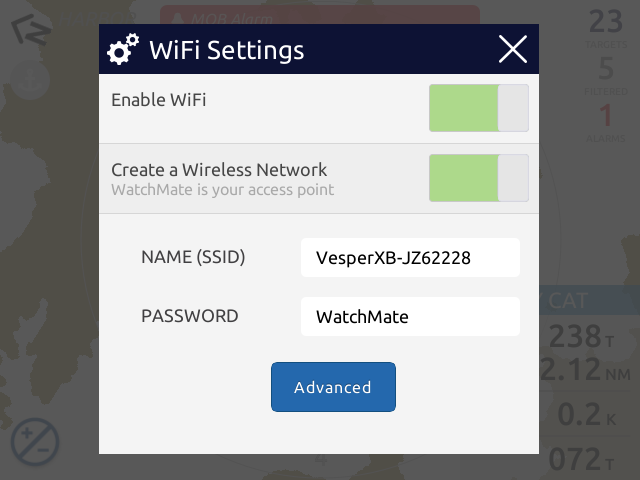

Setup WiFi to create its network as an access point
The WatchMate Vision transponder is already configured as an Access Point; this is the most common way to use the WatchMate Vision, and allows up to five other devices to connect via WiFi. A separate WiFi router is not needed.
The default network name (SSID) is VesperXB-[Serial Number]. Select this name from the WiFi connection screen on the other devices. The default password is printed in the owner's manual.
To change the SSID or password by using the WiFi Settings on the WatchMate Vision or by using the vmAIS Configuration and Status Utility on a PC, Mac, or Ubuntu computer. Vesper Marine recommends changing the password. Use the WiFi Settings dialog, accessed from the Settings Menu, by downloading the vmAIS Configuration and Status Utility (see downloads section) and installing it on the PC Mac or Ubuntu computer. Use the USB cable included with the WatchMate Vision transponder to connect to the computer. Some versions of Microsoft Windows have the driver pre-installed. If on a Mac, the driver is downloadable.
Select the WiFi Settings from the Settings menu to change the SSID and enter the new password.

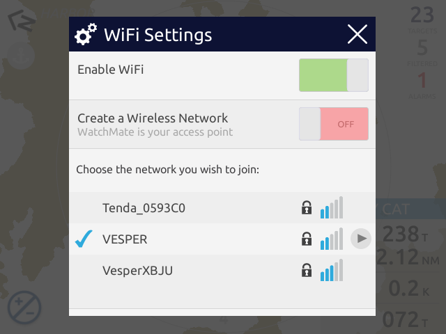

Setup WiFi to join an existing network
Using an existing WiFi router requires configuration on the WatchMate Vision to connect to it rather than creating a network. An existing WiFi router allows a single network connection for all devices without switching networks to access the WatchMate Vision transponder. It also provides more extensive networks than the five devices supported by the WatchMate Vision in its Access Point configuration.
To configure the WatchMate Vision to join an existing network, use the WiFi Settings dialog accessed from the Settings Menu. Alternatively, the vmAIS Configuration and Status Utility on a PC, Mac, or Ubuntu computer can be used. To do this, download the vmAIS Configuration and Status Utility (see downloads section) and install it on the PC, Mac, or Ubuntu computer. Use the USB cable included with the WatchMate Vision transponder to connect to the computer. Some versions of Microsoft Windows have the driver pre-installed, but if not, or using a Mac, download the driver.
On the Vision, from the settings menu, select WiFi Settings. Turn off Create a Wireless Network. It will take a few seconds for the WatchMate Vision to reconfigure itself and display a list of networks within range.
vision 3
Vision 4

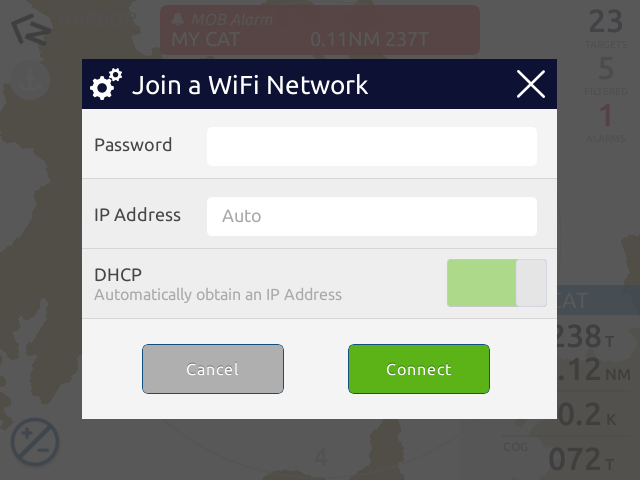

Select the network to join by clicking on the name. Enter the network password, if required. The WatchMate Vision transponder supports WPA and WPA2 personal (PSK) WiFi security.
The default is to use DHCP, which allows the WiFi router to choose the address for the WatchMate Vision. While convenient, the address can change if the WatchMate Vision transponder is powered off. To assign the WatchMate Vision a static IP address, untick the "Use DHCP" option and enter the IP address to be used. It must be an IP address in the correct range the router has available for use as a static IP. See the manual for the WiFi router for details regarding static IP usage and the proper address to enter.
The WatchMate Vision will now connect to the network. When done, the selected network appears in the list with a blue tick next to it. If using DHCP, enter the IP address that the router assigned to the WatchMate Vision. Click on the grey arrow next to the network name to see the router's IP address. The IP address is used to connect to the WatchMate Vision from other devices on the network.
