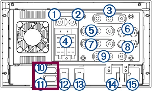

If the error message USB Power Overload appears on a Fusion RV infotainment system when connecting a USB device such as a phone or external storage to the stereo, the USB input is connected to the wrong port on the back of the stereo.
BBT601
The ports marked in red are the 2 USB ports on the back of the dock. The top port, marked with a 10, is a 500 mA USB port for use only by the manufacturer. The USB input should be connected to the bottom port, marked 11, which is a 2.1 mA USB port.
IN1501, Vieo
The ports marked in red are the 2 USB ports on the back of the dock. The left port, marked with a 6, is a 500 mA USB port for use only by the manufacturer. The USB input should be connected to the right port, marked 7, which is a 2.1 mA USB port.
- If the input is connected to the 500 mA port, remove it and connect it to the 2.1 mA port
- If the input is already connected to the correct port, check that the infotainment system is up to date
- See Fusion RV Infotainment Software Versions for current software versions and update instructions
- If the back of the unit cannot be reached, contact the dealership for assistance
If the stereo is up to date and the USB input is connected to the correct port, contact Product Support.
