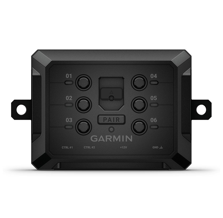

The Garmin PowerSwitch has a status LED below the pairing button. The LED illuminates different colors depending on the device status.
Here is a breakdown of the different LED meanings.
Flashing Red
Slow flashing red light:
  • Status when powered on
Pulsating red light:
  • Device powerup
Flashing Blue
  • Device in pairing mode
Flashing Green
  • An update is being installed
Flashing Purple
  • Factory Reset
No Light
  • The device is not connected to a power source
