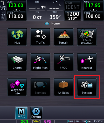

From the Home screen:

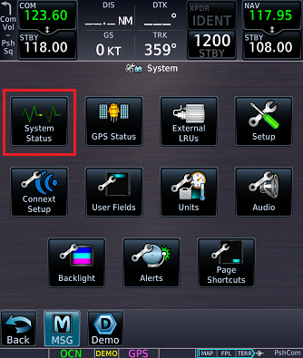

1.) Tap on System.
Update GTN Xi DB switch 1
2.) System Status.
Update GTN Xi DB switch 2

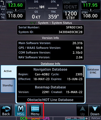

3.) Menu.
Update GTN Xi DB switch 3

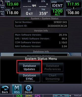

4.) Database Updates.
Update GTN Xi DB switch 4

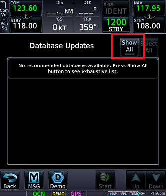

5.) Show All.
Update GTN Xi DB switch 5

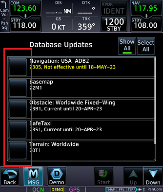

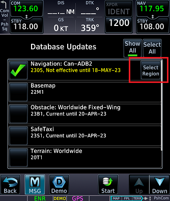

6.) Select the database(s) you wish to change the region for by tapping on the box next to the respective database. After touching the box, a green check mark will appear.
Update GTN Xi DB switch 6

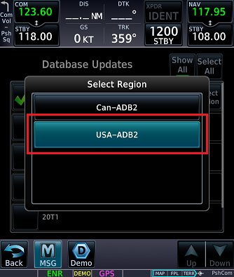

7.) Once the box is selected, a Select Region button will appear when more than one region is present for the same database and cycle. Press the Select Region button to select the region that you wish to make the active database. For demonstration purposes, we will choose USA - ADB2.
Update GTN Xi DB switch 9
Update GTN Xi DB switch 10

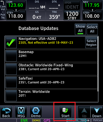

8.) After selecting the databases you wish to update, press the Start Button
Update GTN Xi DB switch 11

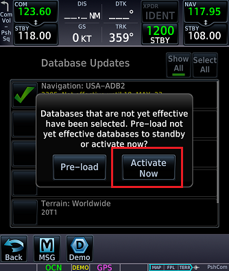

9.) A box may appear stating: "Databases that are not yet effective have been selected. Pre-load not yet effective databases to standby or activate now?" Pressing "Activate Now" will make the database that you have selected the current database.
Update GTN Xi DB switch 8
