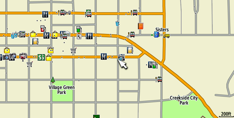

    • If the setting says Declutter On, then declutter is currently turned off.
      Example of Declutter Turned Off
      GPSMAP 276Cx Declutter Off

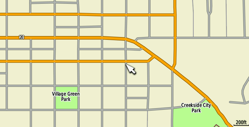

    • If the setting says Declutter Off, then declutter is currently turned on.
      Example of Declutter Turned On
      GPSMAP 276Cx Declutter On
