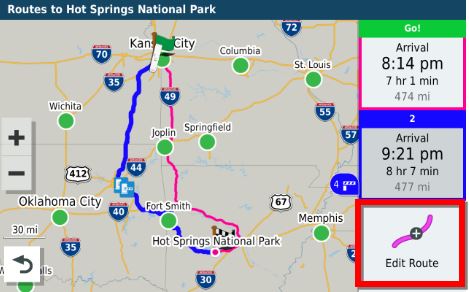

To Select an Alternate Route:
1. Touch the Routes option instead of Go
2. Select an Alternate Route and Touch Go
To Edit (Shape) the Route Manually:
1. Touch Edit Route
2. Select a location on the map
    • Allow the route time to calculate
3. Touch the map again for each additional location
4. Touch Go when you finish shaping the route
You can add up to 30 shaping points to your route.
After hitting Go the device will calculate and have you on an Active Route. This Active Route can be edited further and saved in Trip Planner.

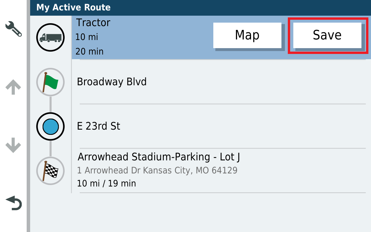

To Edit and Save an Active Route:
1. Touch Apps
2. Touch Trip Planner
    • You have may need to touch Navigation or dezl first.
3. Touch Saved Trips
4. Touch My Active Route
5. If edits to the active route are needed, touch the wrench icon in the top left
Editing and Trip Options:
    • Route Preference
    • Suggest Attractions
    • Shape Route
    • Stop Route
    • View Turns
    • Edit Schedule
6. Once the edits have been made, go back to the Active Route and touch Save
7. Type the desired name for the route, then touch Done
The custom route will now be saved as a trip in Trip Planner.
