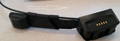

Slide the Antenna through the existing Keeper
A slight bend allows for sliding the Antenna

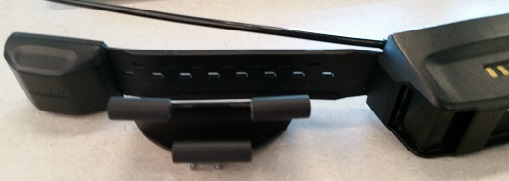

Remove the existing Keeper
Install the Ballistic Keeper in the reverse manner
