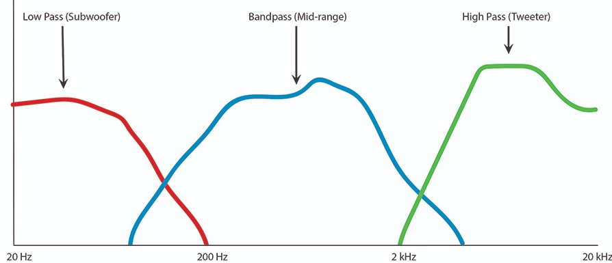

There are three basic ways to “crossover” or divide frequencies.
High-Pass Filter: allows frequencies above the chosen cut off frequency to pass through to a speaker or group of speakers.
Low-Pass Filter: allows for frequencies below the chosen cut off frequency to pass through to a speaker or group of speakers.
Band-Pass Filter: uses a combination of a High Pass Crossover and a Low Pass Crossover to allow a range of frequencies above and below two chosen crossover frequencies (one High Pass and one Low Pass) to pass through to a speaker or group of speakers.
