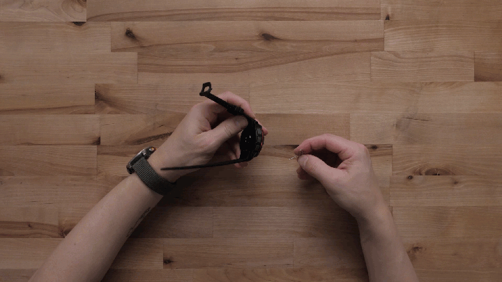

  1. Use the paperclip and press in on either side of the pushpin.
  2. Pull down gently on the band so that the side of the pushpin you are pressing in on releases and separates from the watch.
    Using paperclip to remove Instinct 3 watch band
  3. Complete steps 1 and 2 on the other side of the watch band side.

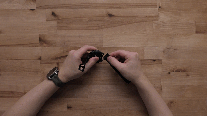

  1. Place the new pushpin into the new watchband.
    Pushpin Inserted in Band
  2. Align one side of the watch band so that the pushpin goes into the watch band hole.
  3. Compress the other side of the pushpin and push the band up, pressing the watch band into the slot.
    Pushing watch band into place GIF
  4. Make sure the band pin aligns with the holes on the watch and the band is secure.
  5. Complete steps 1 through 3 for the other watch band side.
