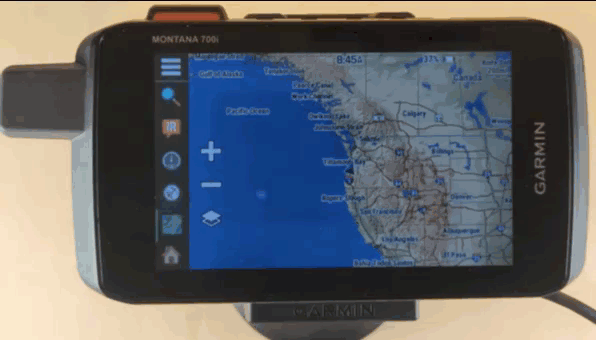

Adjusting Volume
NOTE: The volume option only appears when connected to a compatible speaker mount.
  1. Connect the device to a headset or speaker mount.
  2. Tap the Power Button once or swipe down from the top of the screen to access the status page.
  3. Use the volume slider to adjust the volume level.
    Adjusting the Volume
