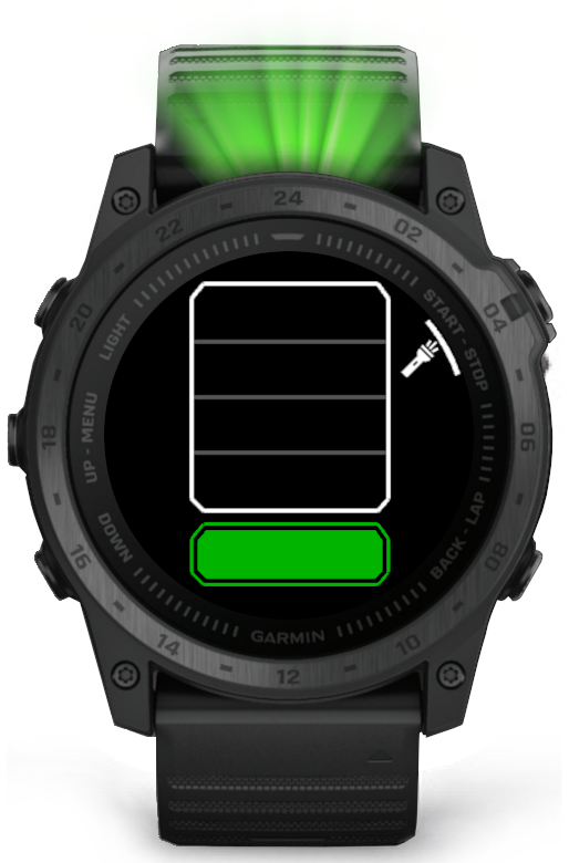

    Secondary Color Light
    Press UP or DOWN until the separate bar at the bottom is selected. For most watches the secondary color is red, but for tactical watches the secondary color is green.
    fēnix 7X Flashlight RedorTactix 7 Green Flashlight
