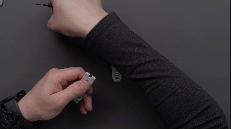

Removing the Buckle
  1. Use the pin removal tool to push in the buckle pin.
    Step1
  2. Remove the buckle.
    Step2
  3. Use the pin removal tool to push out the watch pin.
    Step3
  4. Remove the tongue piece.
    Step4

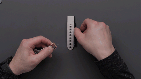

Attaching the Buckle
  1. Push in the buckle pin half way.
    Step5
  2. Put the tongue piece in the small gap and push the buckle pin in completely.
    Step6

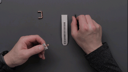

  3. Align the buckle holes with the buckle pin.
    Step7
  4. Use the pin removal tool to push in the buckle pin.
    Step8
  5. Ensure the buckle pin is secure and the buckle remains in place.
