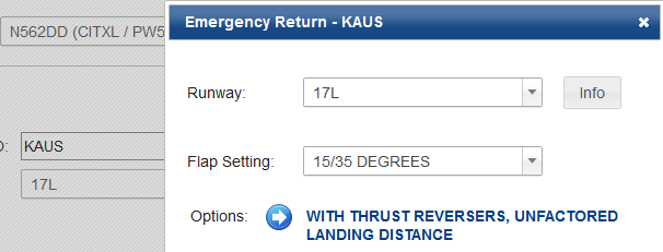

  1. Click on the Performance tab to access the performance section. Here, select your departure runway and click ER. This will provide the emergency return analysis data like weight, landing distance, speeds, etc.

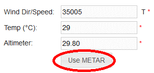

  2. Select the Use METAR button to insert current weather, or enter expected values for "Wind Dir / Speed", "Temperature", and "Altimeter".

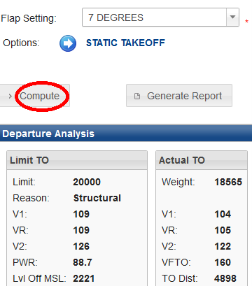

  3. Select your Flap Setting and select Options for takeoff such as "EEC Inop", "wet runway", "snow", etc.
  4. After these settings are selected, click the Compute button and the values for takeoff weight, thrust setting, and level off altitude are displayed under the "Departure Analysis".
