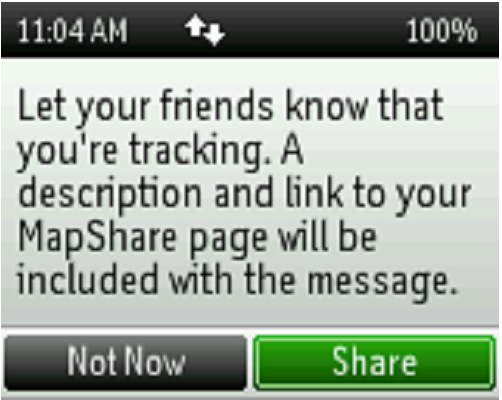

  4. If you would like to compose a message with your MapShare™ link2 to friends or family member select Share, otherwise select Not Now.
    NOTE: This screen will not appear if it was disabled in Settings > Tracking > Prompt for MapShare.
    Example of Not Now and Share Buttons
