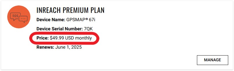

Verifying the Subscription Status
When signed into your account at Garmin.com, you can view your subscription(s) by selecting Account Profile Icon in the top right corner of the page, then Account. From there select SUBSCRIPTIONS & SERVICE PLANS on the left of the page. If the subscription is listed under ACTIVE and shows a monthly price associated with it, the subscription is active and you can proceed with testing your inReach service.
Active inReach Subscription Example
If the subscription is listed under ACTIVE, but shows 0.00 monthly price associated with it, the subscription is suspended and will need to be reactivated. For steps, see - Reactivating a Suspended inReach Device.
If the subscription is listed under INACTIVE, a new subscription will need to be activated by paying an activation fee. For steps, see - How to Activate an inReach Subscription.

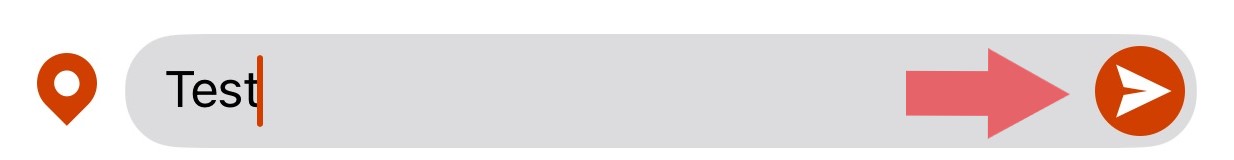

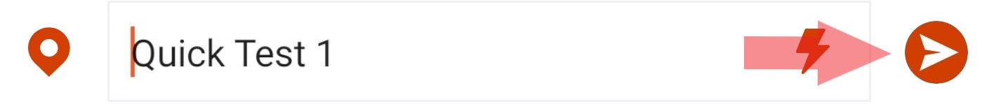

Testing inReach Service From the Garmin Messenger App
  1. Enable airplane mode on the paired smartphone.
  2. Take the smartphone and the inReach device outside, powered on, with a clear view of the sky.
  3. Open the Garmin Messenger app.
  4. Select Messages Word Bubble Icon.
  5. Select Pencil Icon Android (Android) or Pencil Icon iPhone (iPhone).
  6. Touch the field next to To:.
  7. Enter testinreach@garmin.com.
  8. Touch the Start a new message field, then type out the message.
    TIP: The message field can simply contain "test".
  9. Touch Send.
    Garmin Messenger Message Send Icon
Wait while the message sends. When you receive a confirmation message back, your inReach device is ready to use.
