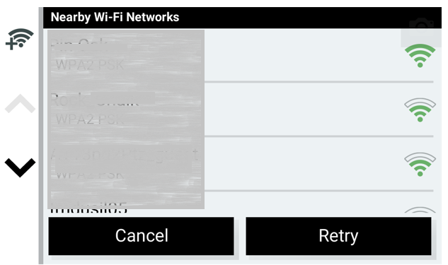

To Connect the Device to a Wi-Fi Network:
1. Plug the device into a power source
Touch the 'X' in the lower right corner if the message "Tap to Connect to the Computer" appears
2. Touch Settings or the gear icon
3. Touch Wireless Networks
4. Select the checkmark box to enable Wi-Fi technology if necessary, then touch Search for Networks
5. Select your network
6. Enter the password for the network and select Done
The device should then connect to the network. The network will be added to the list of saved networks. The device will reconnect to this network automatically when it is within range.

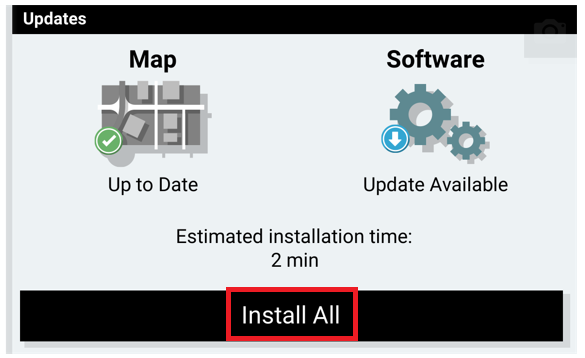

To Check for and Install Both Software and Map Updates on This Device:
NOTE: Updates will not be available if the device is on the latest version.
1. Touch Settings or the gear icon
2. Touch Updates
3. If prompted, touch OK to the message 'Connect to a Wi-Fi network to download updates.'
    • Select a network, enter the network password then select Done.
4. Select Install All if an update is available
The device will check for available updates once connected to a Wi-Fi network. A prompt will appear to install them if any are found.
NOTE: The device will be unusable until the updates complete.
