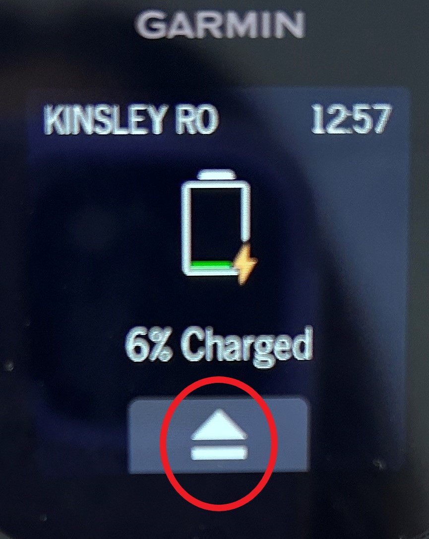

Verify the Watch Has Entered Mass Storage Mode
In order for Garmin Express to find your watch it will need to enter into Mass Storage Mode. Typically, when your watch has successfully entered into Mass Storage Mode, the screen will display a Battery symbol with a plus signbattery charging icon and the A black triangle with a black line underneath eject symbol. For example:
Garmin Bounce in Mass Storage Mode Showing the Eject Symbol and Charging Icon
