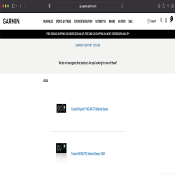

  2. Enter the device name or serial number to search for and select the device
    Fusion Software Update Using Mac Step 2Fusion Software Update Using Mac Step 3

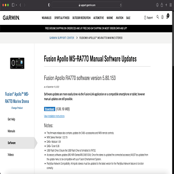

  3. Select Software on the left side of the page
    Fusion Software Update Using Mac Step 4

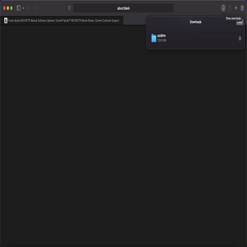

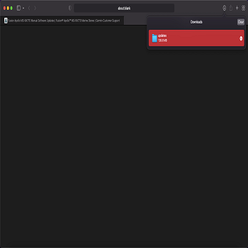

  4. Select Download to begin downloading the update file
    Fusion Software Update Using Mac Step 5Fusion Software Update Using Mac Step 6

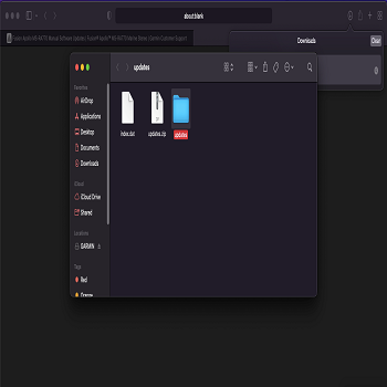

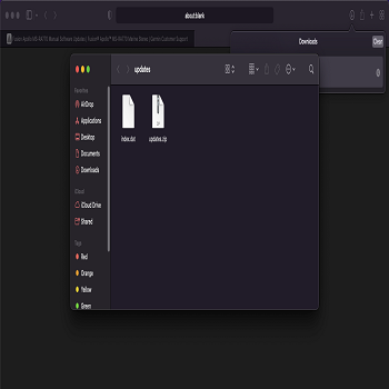

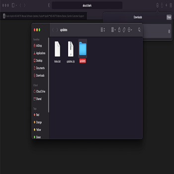

  5. Open the downloaded file and an updates folder will be created
    Fusion Software Update Using Mac Step 7Fusion Software Update Using Mac Step 8

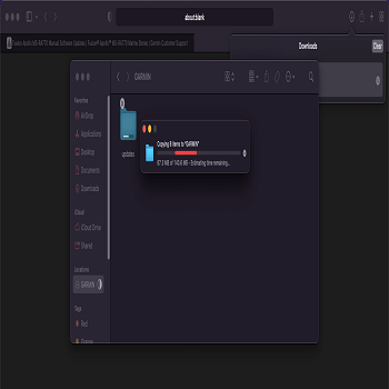

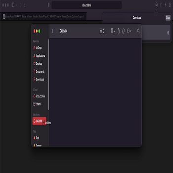

  6. Drag the updates folder to the USB flash drive under Locations
    Fusion Software Update Using Mac Step 9Fusion Software Update Using Mac Step 10Fusion Software Update Using Mac Step 11

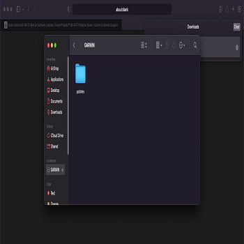

  7. Open the USB flash drive to confirm the updates folder is present
    Fusion Software Update Using Mac Step 12
